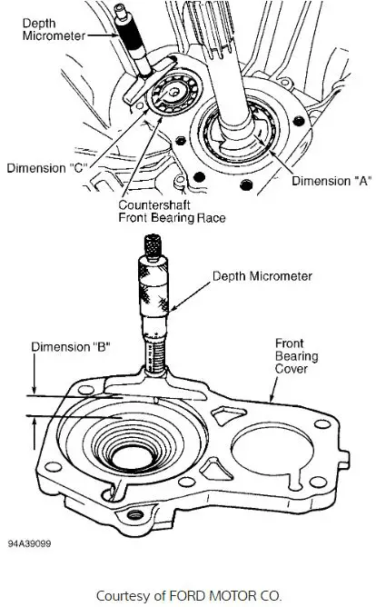

As far as endplay goes... where and how do I measure that? I apologize for the noob question, I'm assuming you're referring to the main shaft assembly moving forward and backward in relation to the trans case itself? That is set by the input shaft bearing shims, correct?
With the tailhousing removed I do have a bit of movement in every direction at the middle main shaft bearing (at the rear bearing retainer.) Not very much, but noticeable. I don't know if that's normal and caused by the rear bearing not being supported by the tailhousing though.
From what I found Ford says .002 to .006 for the input shaft and .006 to .010 for the counter shaft.
I would only be worried about the movement of the main shaft in a forward and back motion with the tail housing removed.
