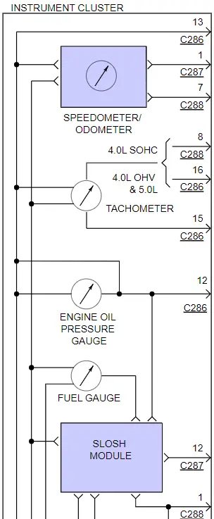

A good it late, but here the comparison. Apparently the swap over year was part way through 97. Here in the diagrams you can see the resistors that are missing from the later versions. I do want to try and complete this in the future so Im posting it here for others. the resistor in question is 115 ohms otherwise identical layout. pin 12 C286 goes to the pressure switch pin 13 C286 is power
