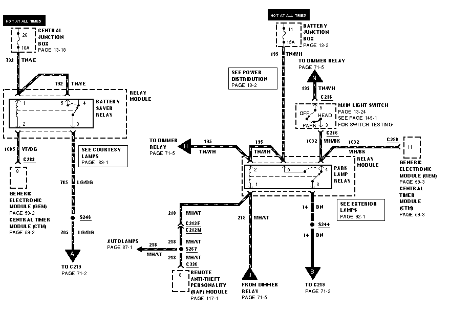

I've had a problem pop up that may be very annoying, hopefully someone has a quick answer for me.
I keep blowing fuse #11 under the hood (book says parklamps relay and Mainlight switch). Which pretty much explains what's going on.
When the fuse blows my tail lights, and front marker lights go out, as well as my dashlights, and I believe my fog lights. My brake lights work fine, and my headlights will come on if I turn the switch on.
I have searched here, and tried replacing the main switch, and swapped the relay with the interior lights relay, no change.
After I replace the fuse, I'm pretty sure all the bulbs work, but I cannot remember if the foglights worked or not. The first time I replace the fuse it lasted 2 days, today it lasted about 10 minutes.
In this part of the world, days are getting short, and "I'm sorry officer, I just picked up a switch to fix it tonight" aint gonna cut it for long.
Anyone had problems with the wireloom shorting in a particular spot?
Anyone else had this problem that fixed it in a different way?
Oh yeah, one more weird thing, when the fuse is blown and I turn on my lights, ALL of my dash indicators go out (cruise, O/D. 4x4, etc), as soon as I turn the switch back off, they return.
