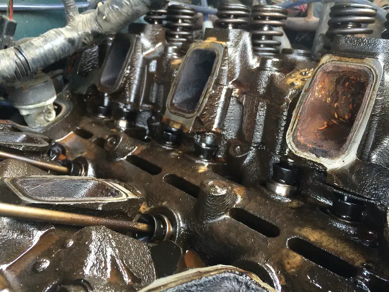

Pulled the top end apart today, and found a great deal of bad news. :(
The left front cylinder has significant corrosion in the intake runner, so it looks like it's been leaking water in there for quite a while.
And judging by the underside of the manifold, the oil/water mixing has been extensive. Whole top of the engine is filled with this sludge, and the coolant passages are almost completely blocked with rust and crud.
