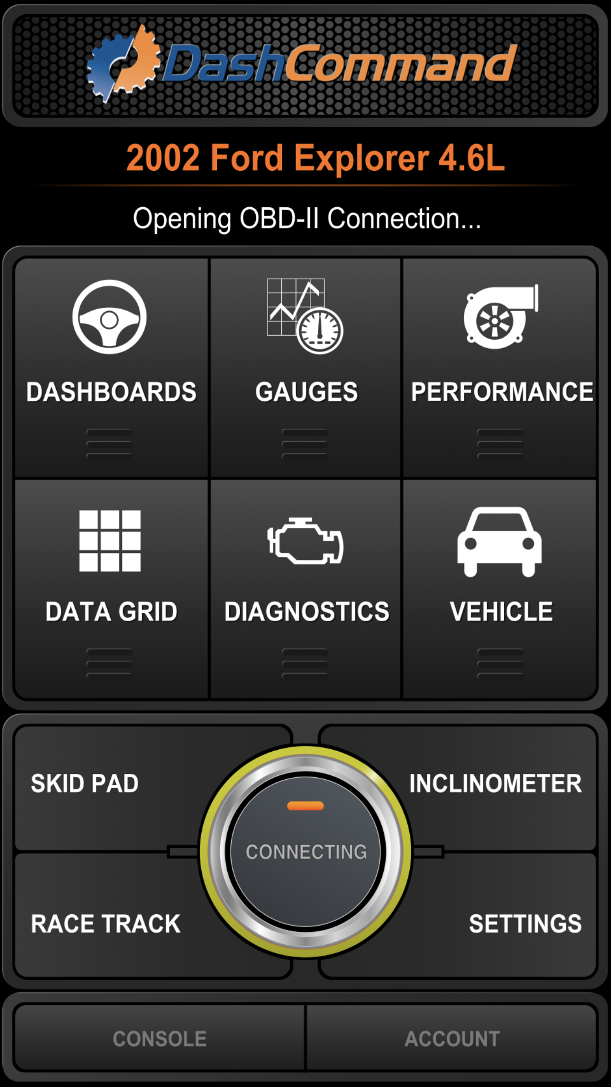

Let’s see if this works - this is the gauge panel from the scanner I’ve got - mine won’t register with that ForScan program so I’m using DashCommand which seems to work alright. I had started it and it threw a code for Ignition coil F which I’ll upload a picture of as well if I’ve got it.
Load % is only barely sorta kinda not really accurate even if you set it up. Default is: 4 CYL 2.0L engine.....
It’s set by the vehicle - shows it as a 4.6 as well in the settings
