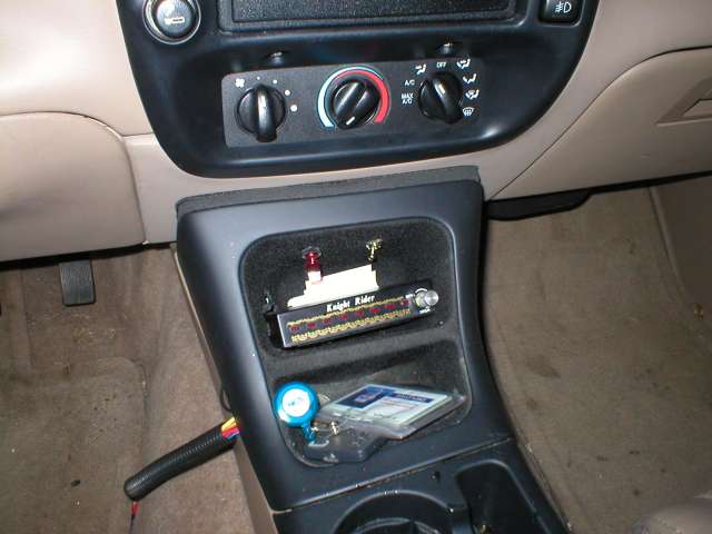

How bout some pics? Sure!
Before...
Testing it all out...
Success!! Such a cleaner look too... :D
Ooo congrats on the hard work paying off... believe me, it'll be worth it in the end. I use my message center everyday, one way or another. :thumbsup:
Awesome, looks great.
Thats quite a wire mess back there. I hope you got it under control.
It looks real good, nice work.
Looks killer. I've been wanting to install one in my 96, but with my luck aomething will blow up. :)
Thanks for the compliments guys!!
Don't be intimidated by it...its really not that hard of a project. If you have the right parts, I say go for it!
The wires were only like that temp. as I was testing it to make sure it even worked. Now they're all neatly bundled and tied together like a factory type harness. It looks as though it came from the factory w/ the MC now. I love it! :D
