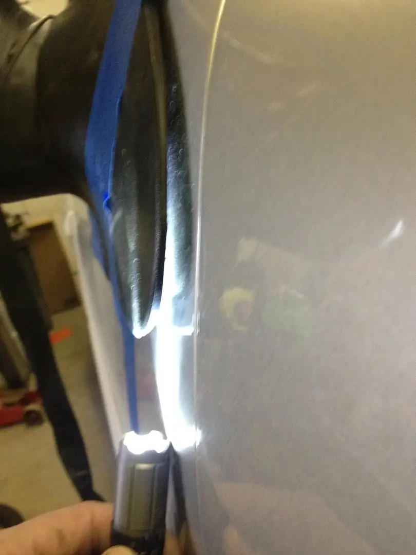

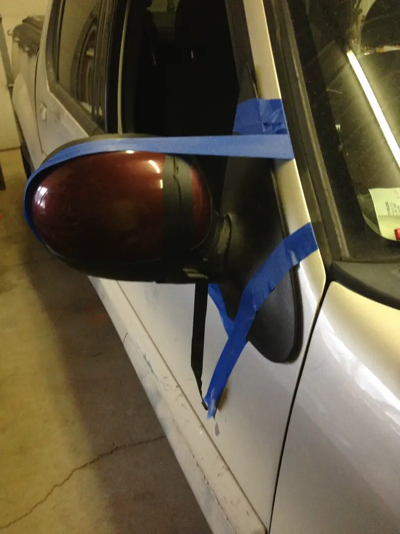

well hear it is mind you its just taped on hear is what we are working with. i removed the mounting studs and trimmed the locating features
I love the tape lol! ! ! That's something I would have done just in time for the woman to start laughing at me.
So the top and front line up, but it hangs too low and comes into the window. Is the mirror the right height? Or would it need to move up (and throw everything off)
New thought. Use the mirrors from a Lincoln Aviator (the explorer equivalent, not the navigator).
it lines up perty well, i might have it tiped forward to much as i have the mirror adjusted all the way in to see tight along side the truck and yeah tape works well for mocking it up.... and yeah ten dollars for a snapped off mirror was better then 75 for a good one to test fit. a little heat gun and trimming after these pics got it kinda close.
