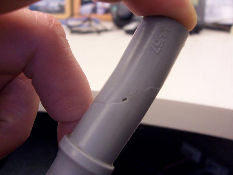

I had the exact same symptoms. Had a pinhole in one of the spark plug wires. Never arced in the dark in the driveway, no codes. Just under load, and at 45-50 mph, and occasionally when it was raining. Could not see anything obvious. But when i replaced the wires, I found the tiny pinhole. They were silicone taylor brand too. Maybe I weakened it on installation, maybe a defect. i dunno. Couldnt believe i didnt get a misfire code.

yea i couldnt believe it didnt throw out a misfire code. i mean, it was a damn misfire ! But it didnt, and I have seen the misfire code on other occasions. I'm serious, the pinhole was just that, and on the bottom part of the boot. not detectable until i one by one took them off and found it. I then bent the boot, it cracked, and you could see the tiny "wormhole" the arc was taking. might take some time to inspect them, but you may find it. and you might only have to replace one wire

They do look great dont they. I like the blue. I still have 4 in use. I did have the one fail, but I think that can happen to any silicone wire. Theyre pretty soft...The pic shows the hole. the hole was alot smaller originally, but has gotten a little bigger from showing people. the cracks happened when i twisted it off for inspection.

i used the grease, but sparingly. maybe too sparingly. but they werent fused to the plugs, though. I think I just got a bad one. The 4 still there are now 18 months with no trouble. looks funny though, half blue, half grey haha
