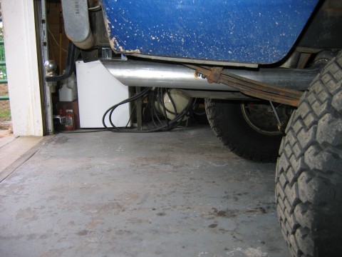

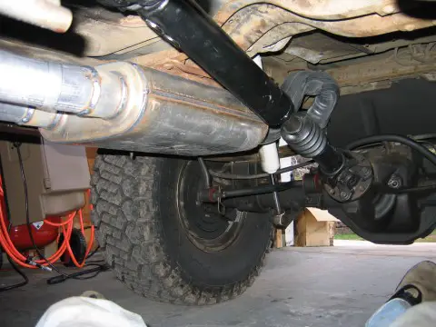

Would you reccommend a dual exhaust setup, or single? Any preference on the size of the tubing?
MoabB2,
Use a Duel in Single out Muffler. The Exhaust on 410Fortune's BII in Colorado is very nice. I've got to give him high marks. I've enclosed a few of his photos. Make sure you have back-pressure and you'll run all over those hills.
Bob Pasquale
Tech Performance & Engineering
Torque Monster Headers
