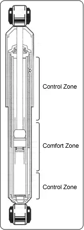

Sensatracs have 1-2" of "comfort" damping on center of the excursion. You lifted the suspension, so now your "at rest" location is in a different part of the shock ( because is extended).
Now you have a harsh ride on asphalt with small bumps, but when the bump is larger (compressing the shock), suddenly the shocks arrive in the "smooth" position - so now, when you would need a stiffer shock you have a "loose" one.
So basically you bounce all over the place on large bumps, but you have a rocky ride when street is smooth.
What's even worse is that it is asymmetrical - compression bounces will act different from the extension ones.

Nailed it Sonic. Some here continue to believe the SensaTracks will work. As designed for primarily for towing, the shock takes the added load and enters the comfort mode-perfect for highway towing. You just get a little lift with zero or little ride quality improvement.
