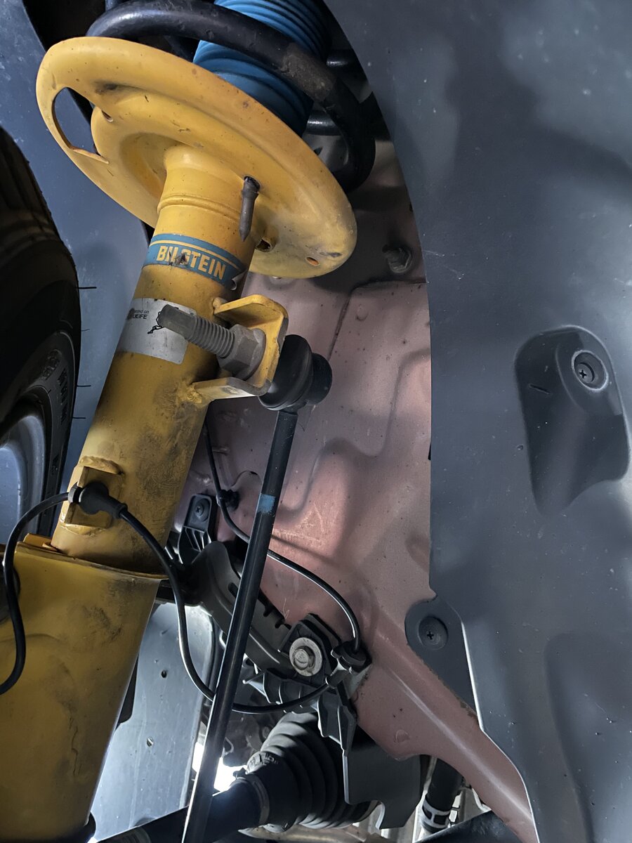

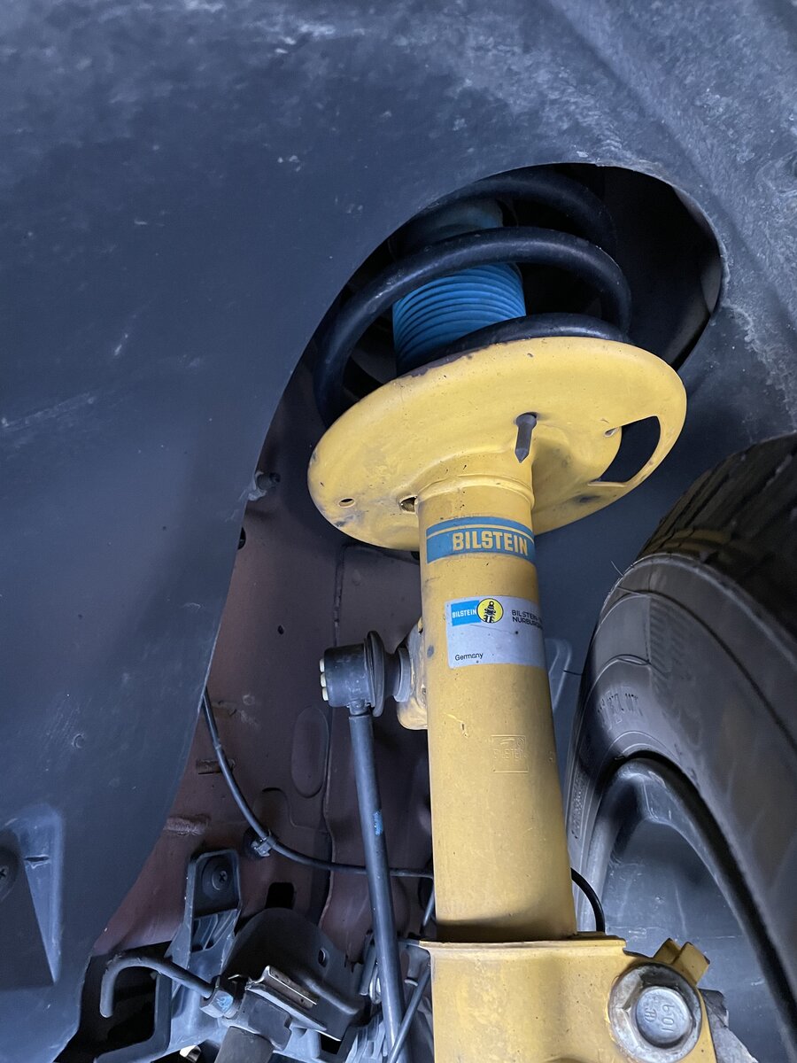

The clunking noises you’re hearing are most likely your strut mounts. I’ve had to replace both sides twice in last 175,000 + miles. I’ve stuck with motorcraft both times but it’s still a bummer. When I replace them, the clunking goes away. Ford has given me free replacements both times in exchange for the old ones! BTW, I put the B6 Bilsteins on with factory springs over 100,000 miles ago. They’re amazing /transforming. These are much higher performance than the B4. I have B6 shocks in the rear as well. It’s a simple bolt in job really. If you’re uncomfortable with compressing the springs, take your new struts into a good local neighborhood alignment shop and ask them to build your strut for you. Most charge about 50 bucks if they’ve got a spring tower and most good alignment shops do!
