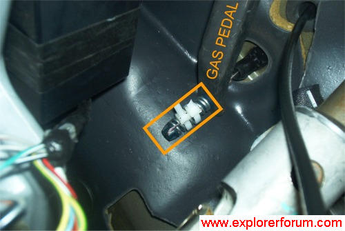

I have read these posts a bunch but i still dont get what you mean to just liek zap strap it to get rid of the slack. can someone show me a picture? thx

someone posted a picture :)
I'll try to get a pic for you.

where is that? i cannot figure it out. is it upside down? where is the steeroing column?
The pic is sorta at a weird angle. Get on your back (no jokes) on the drivers side floor and look up where your pedals are. At the very top of the gas pedal you will see a spring. Push the gas pedal to the floor (don't do this with the engine running!) and then pull it to the opposite direction. You'll see that the cable has some slack in it at the very top of the pedal. Fold the end of the cable over and zip-ty it to the spring. That's the way I did it, seems to be the easiest way.
