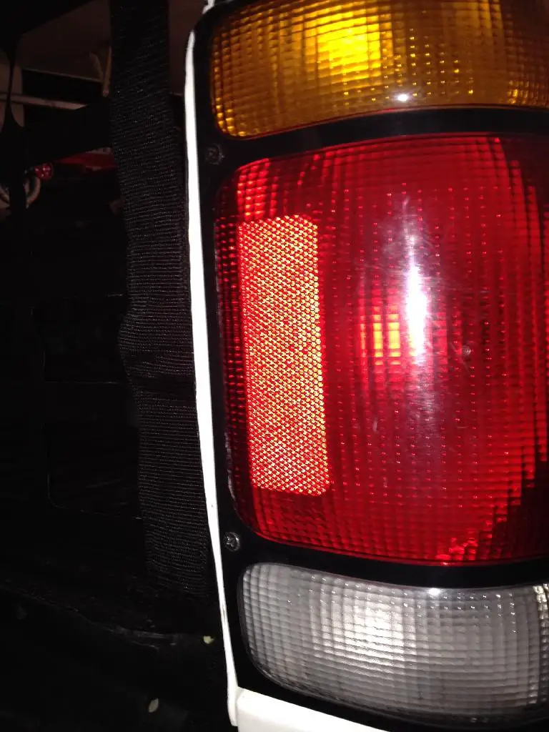

I cut the top tabs off and mounted them thru the lights with pilot holes and sheet metal screws.
Now they pop in and out with ease.
thanks, I was wondering how you worked around that situation, great idea.
sounds liek a good idea, but did you drill right through the plastic lenses? i would think that they woulc collect a lot of moisture as well as be pretty noticable since the stock screws are pretty big.. at least on the early 2nd gens and 2st gens they are, idk about after the newer second gen tail light design tho.

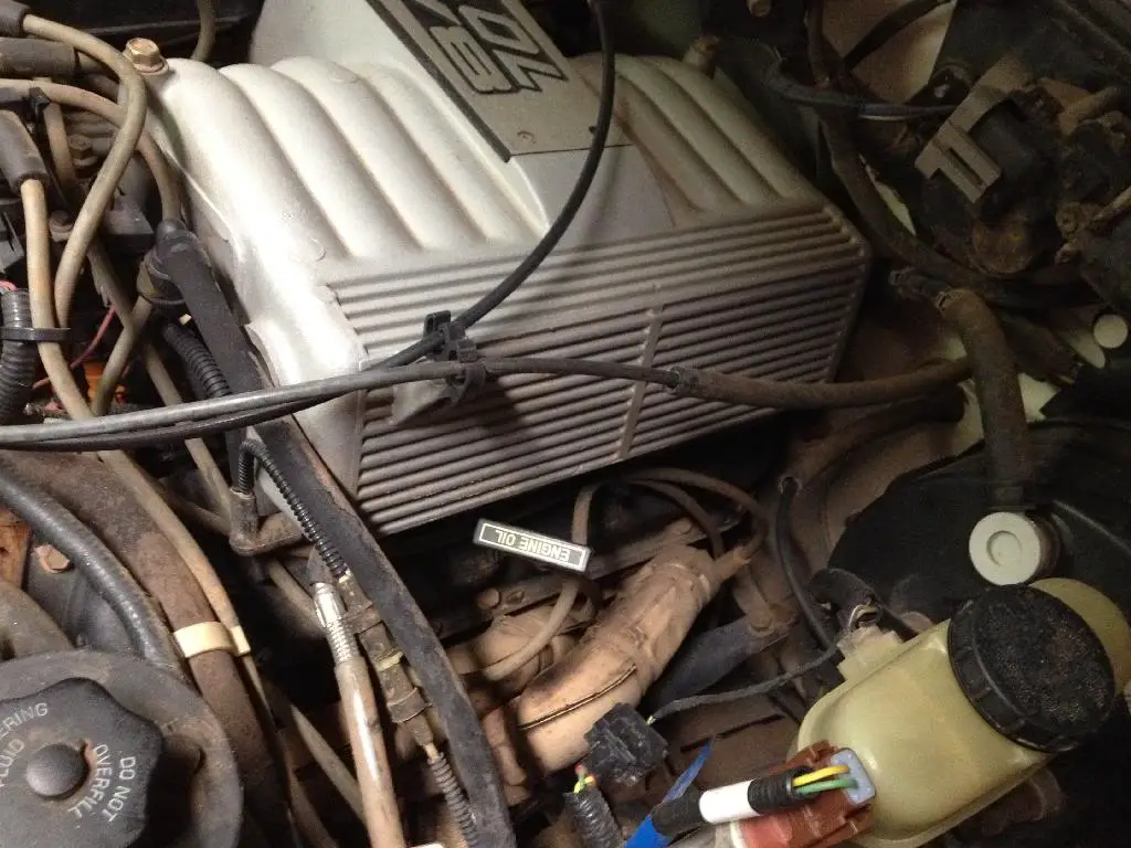

second gen mountaineer with "factory" headers..????
doesn't sound right to me.
got a pic of these headers...??

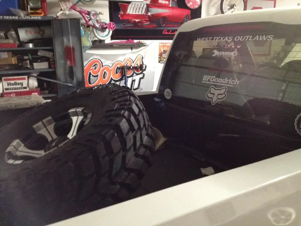

do you have a pic of the finished inside of the bed and the interior?

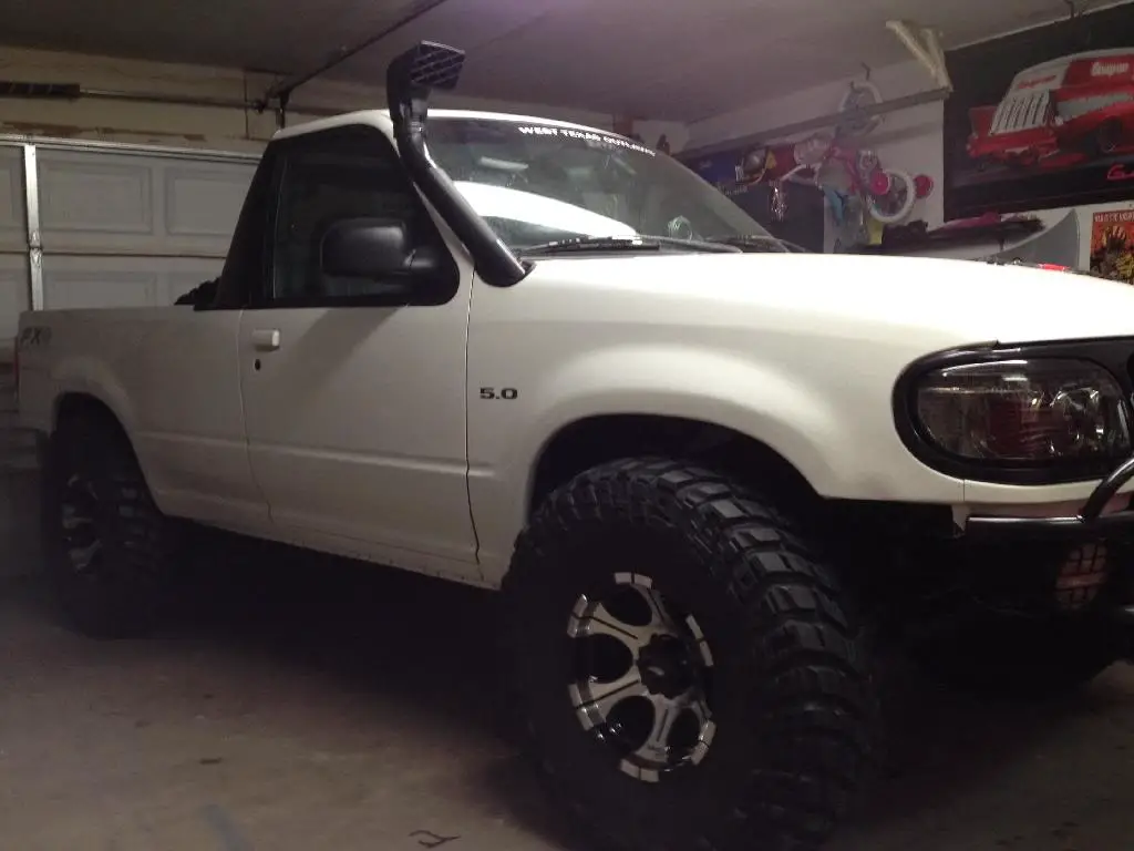

35/12.50/15's installed.
Still gotta do the BL this weekend.
Not bad till then.
Lift looks like it sux balls.
You drill where the plastic molding is sealed.
No water or moisture can get in.
Works great!

Looking good, bl isn't to bad or wasn't for me Matt and I did a 2" bl on mine over the weekend we used his lift to raise the body and placed 4 of the long bolts in first to keep the body lined up then once the blocks and bolts were in placed the blocks on the four remaining spots.
