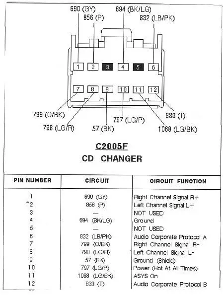

Not sure if you got your answer or figured it out, but here it is:
Get 1 male to male rca cable, cut it in half
In the console, next to the cd changer
Cut 1&7, solder wire going to stereo (input) to red rca do same for wire coming from cd changer (output)
cut 2&8 do the same for the white rca
now you have an input to the stereo and an output from the cd changer, all in rcas

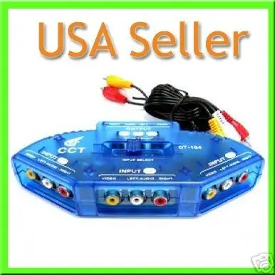

buy something like this:
connect the stereo input to the selector's output, you have 3 inputs, use 1 for the cd changer, now you have 2 left so all you do is hit the cd button and change the selector to whatever source you want (you still need to have cds on your changer as it will still be playing them, but the sound will be coming from another source), sorry I don't have any pics of the setup itself hope this helps enjoy :thumbsup:
