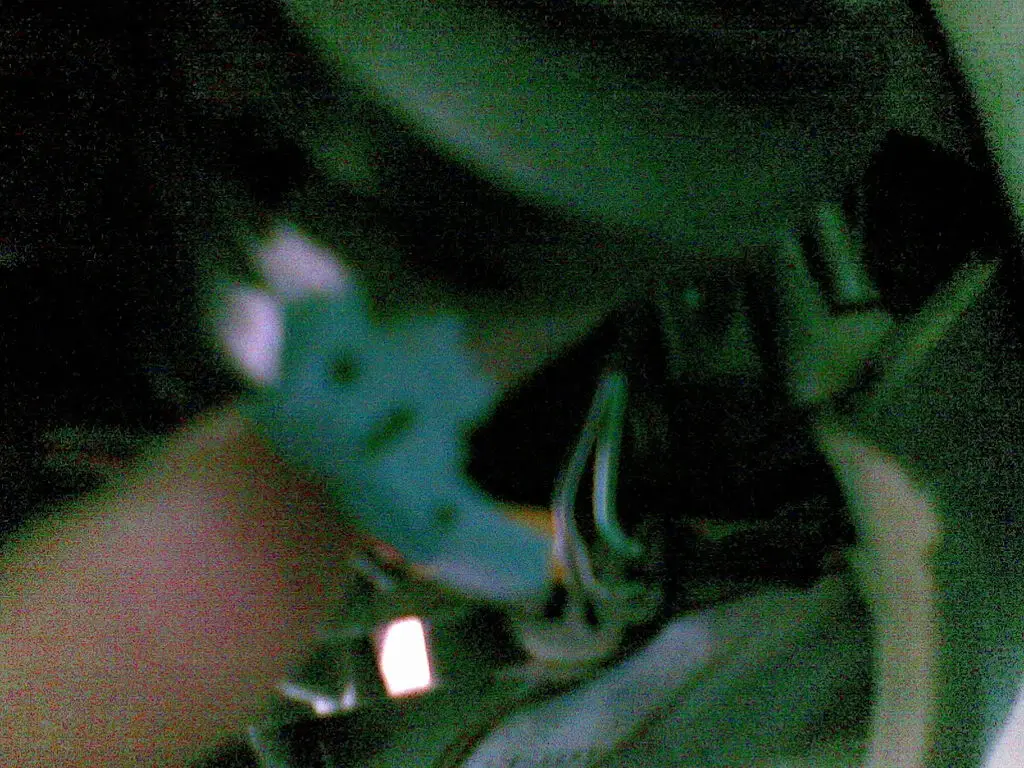

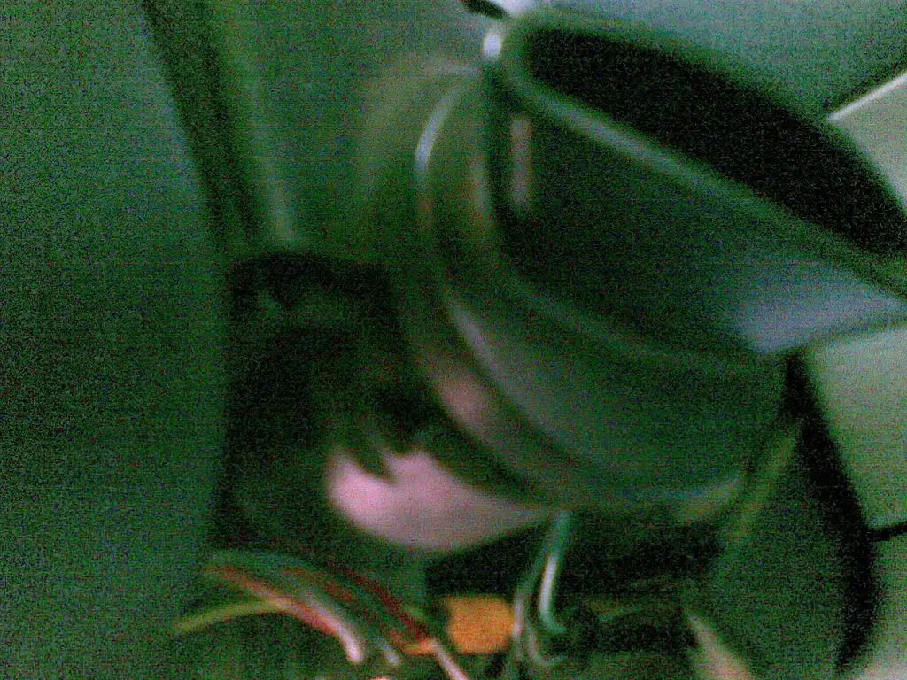

Look here:
For this:
If it's loose, that's your problem, just "plug" it back in
Sorry for the crappy cell phone pix
whoa
Very awesome that you posted some photos.... even if they are REALLY HARD TO SEE. ;)
your response is different than the poster above. You are suggesting there might be a plug, unplugged near the ignition? I will look to see as I still have my column shield off.
thanks.
Fixed!!!
The metal contact on the plug (1) was touching metal on the ignition switch, rather than being plugged into slot (2).
Cool your pic is way better than mine!, glad it helped :D
