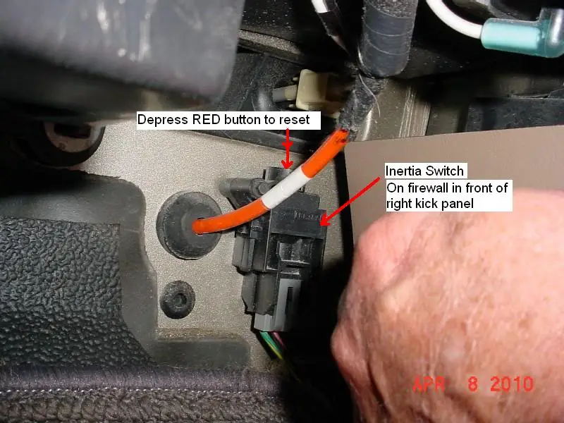

Check the inertia switch under the dash, right side footwell area. If the red button isn't popped up then smack it several times until it pops up and then mash the button down again. Those switches give a lot of problems on Explorers for some reason.
