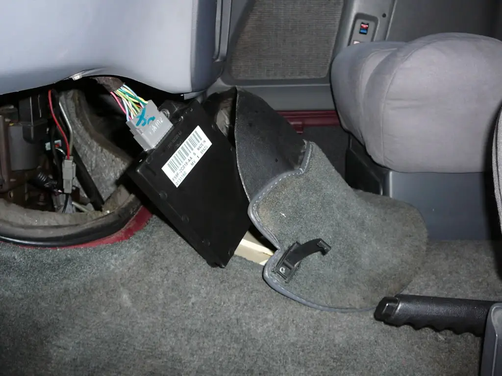

Took a bit to teach myself how to post a picture on the forum hope it works ok. This should clear up what Im calling the ECM and the engine cowl that I had removed. Also engine question yes I think that is what I have 3.0 V6.

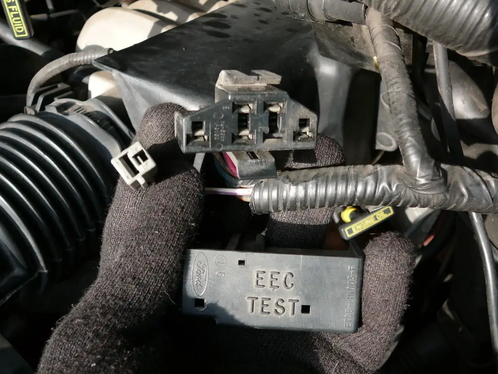

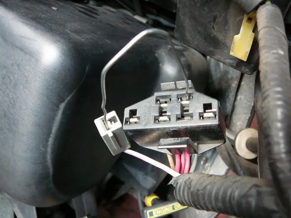

Seems you can run a crude scan with a paper clip to get the codes? Not sure this is true will this work for me?
After more research on the net found what I think you want me to plug into on my aerostar - if this is correct where would I plug in the paper clip? Also can I read the codes from my check engine prompt on my dash as in picture?
Im on a roll now!
Tried fooling around with my trusty paper clip while waiting for someone to get back to me on the forum and SHAZAM I got it to go into the diagnostic mode! ! !:D
Now I have to make sure I can read the blinking code its giving me then I will post for your help wish me luck man-o-man the wind is howling and its still freezing outside today but I feel like with your help Im getting closer to solving this old girls problems!
