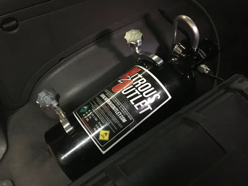

Also I don't like where the pressure switch for the heated bottle bracket is installed. The heated bottle bracket came with an AN fitting adaptor which has a provision(hole) for attaching the switch. If you install it there like I did(as per instructions), when you close the bottle you get no pressure to the switch and the heater will stay on permanently which can cause an over pressure problem and lead to personal injury or property damage. In other words, boom!
I will move the sensor to the bottle valve instead.

The nitrous bottle pressure sensor is now moved to the bottle, much safer. (on right side of bottle valve in picture)

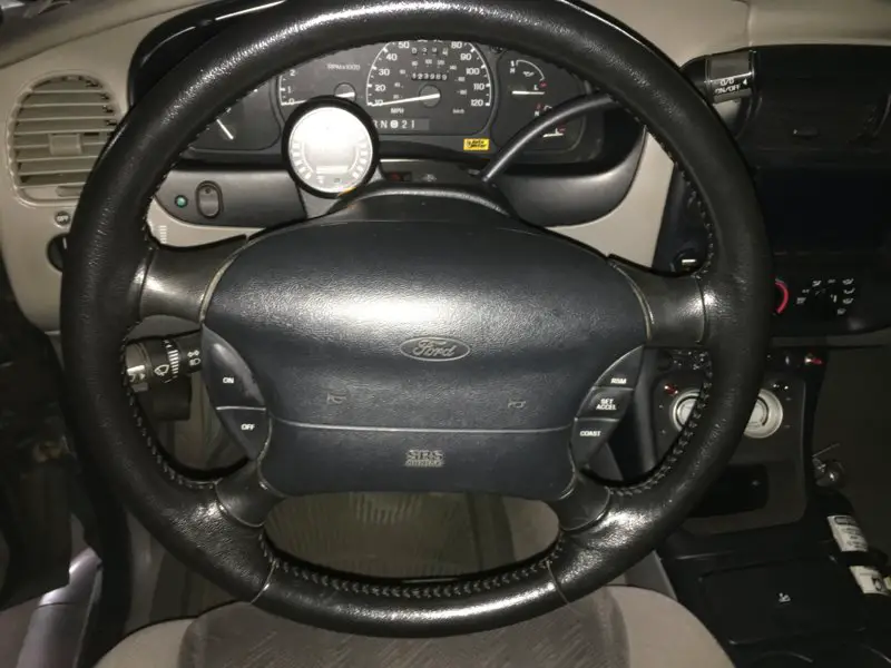

I turned my cruise control resume button into a normally open nitrous switch.
Now when I don't want the controller spraying in others gears, I just don't push the button.
Hoping to test it this coming Saturday at the track. I also plan on installing bigger jets(bigger than 9HP LOL)
