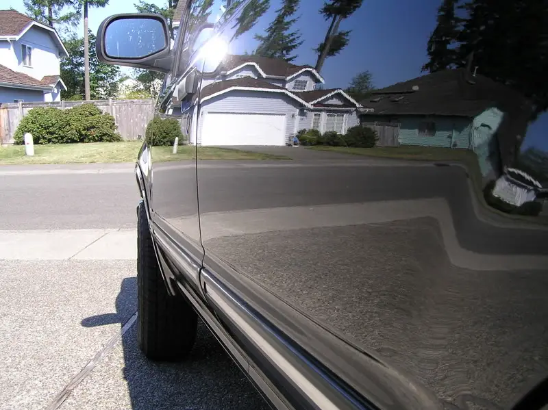

Just finished the entire vehicle...
LOL Dude, I was looking at the picture... thinking you posted the wrong one as I was expecting a picture of the truck. Now I realize its the reflection :D
nice job!
nice job!
I had the same reaction. That is simply awesome!
