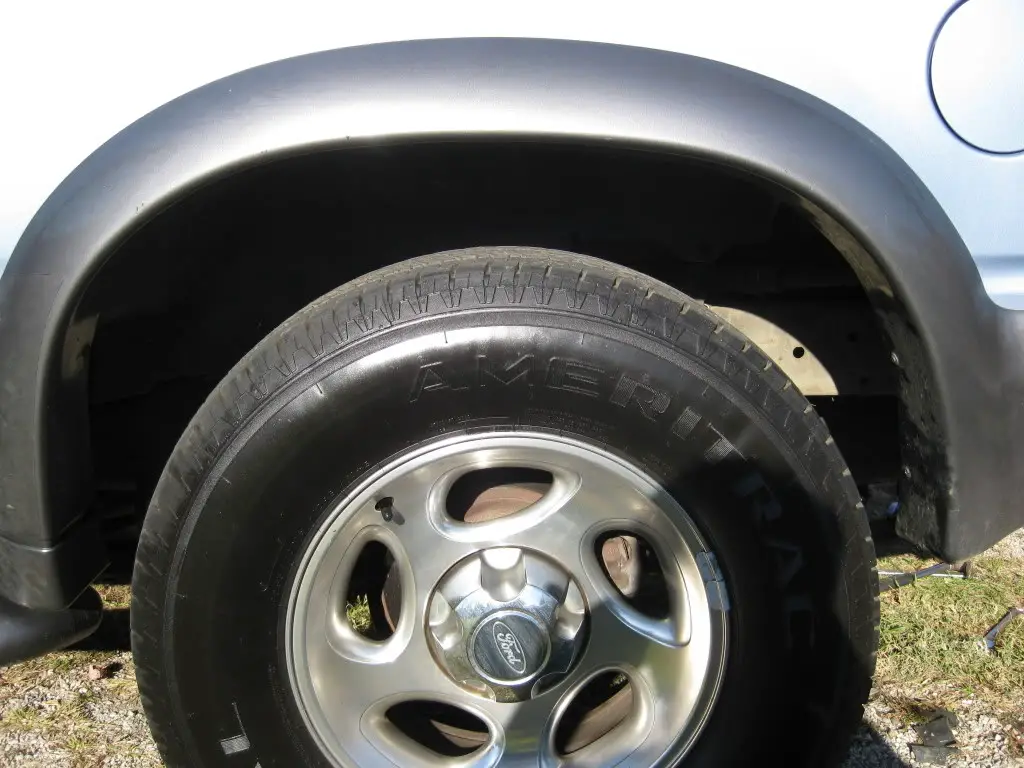

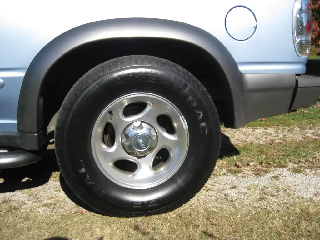

First off i just wanted to thank all the people who helped me out and told me what to buy to raise the back of my explorer a little bit...i ended up getting 2 inches give or a take a little. Here are my b4 and after pics...sorry for the not so good pics wasnt thinking when i took em.
left wheel b4 install
left wheel after install
right wheel b4 install
right wheel after install
please tell me what you think and if any one knows of ways other than the torsion twist to raise my vehicle rather inexpensively please let me know...thank you

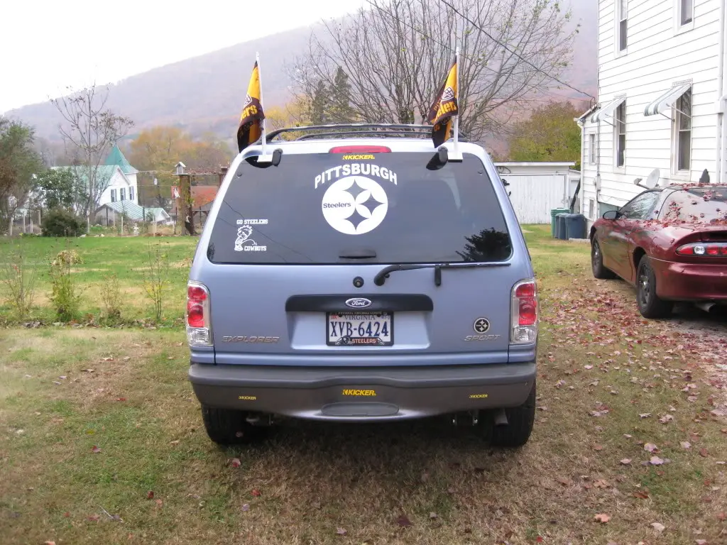

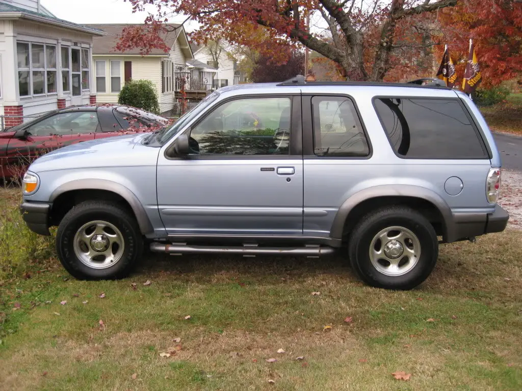

here are some more pictures
back view

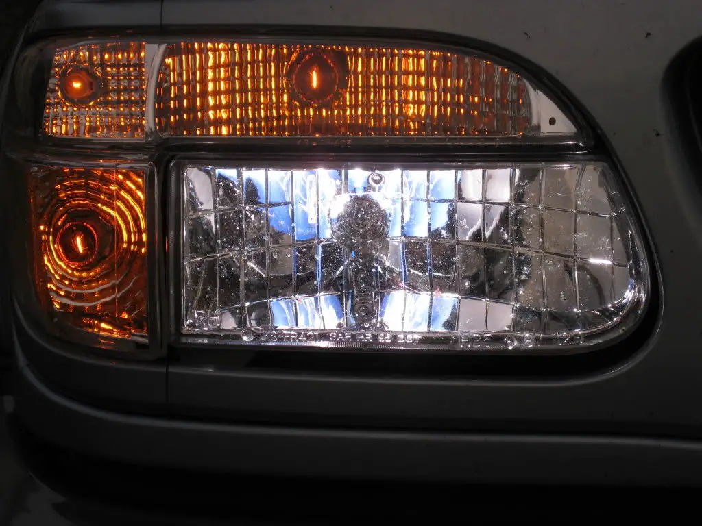

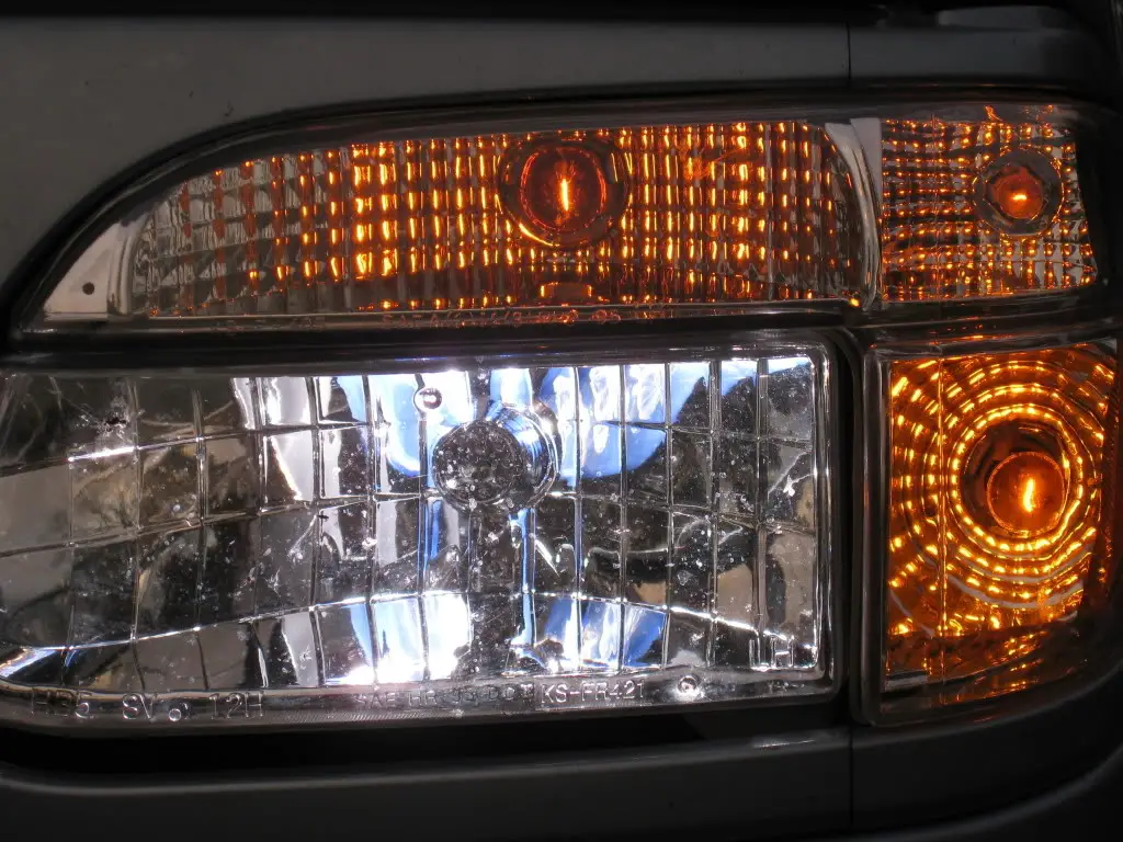

left hid headlight setup
right hid headlight setup
left side view
right side view
so if you take the rear bumper brackets and flip them upside down, then use them on the opposite side they were intended for...it will fit about 1/2 inch higher?
That is correct!:thumbsup:
