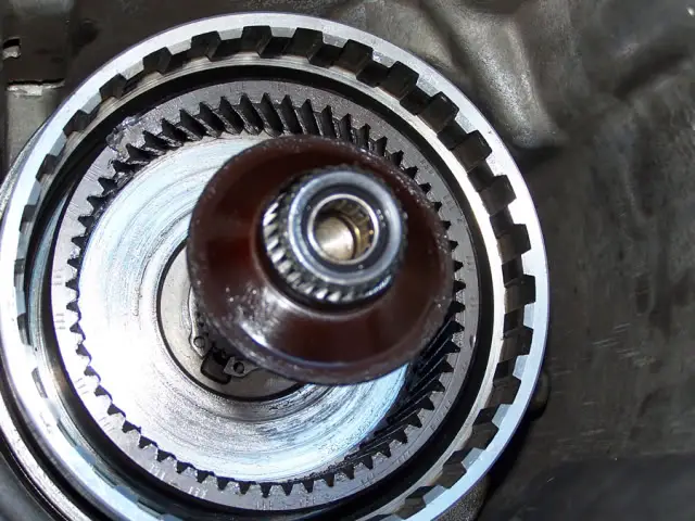

I think this is the #5 thrust washer (Don't worry the baggies are labeled just not the pictures). Is this normal wear?
Yes thats looks normal

picture.php
#10 washer and the back side of the reverse ring gear. Are those grooves supposed to be there or is something missing?
There looks like there is some wear there, it might have the wrong hub it hard to tell from the picture. Some have a bearing here and the are obvious steps to index the bearing, if you can tell it is flat then it looks right but worn, but if its not making metal it should work. I would replace the hub and replace all thrust washers with a thrust washer kit, its cheap.
