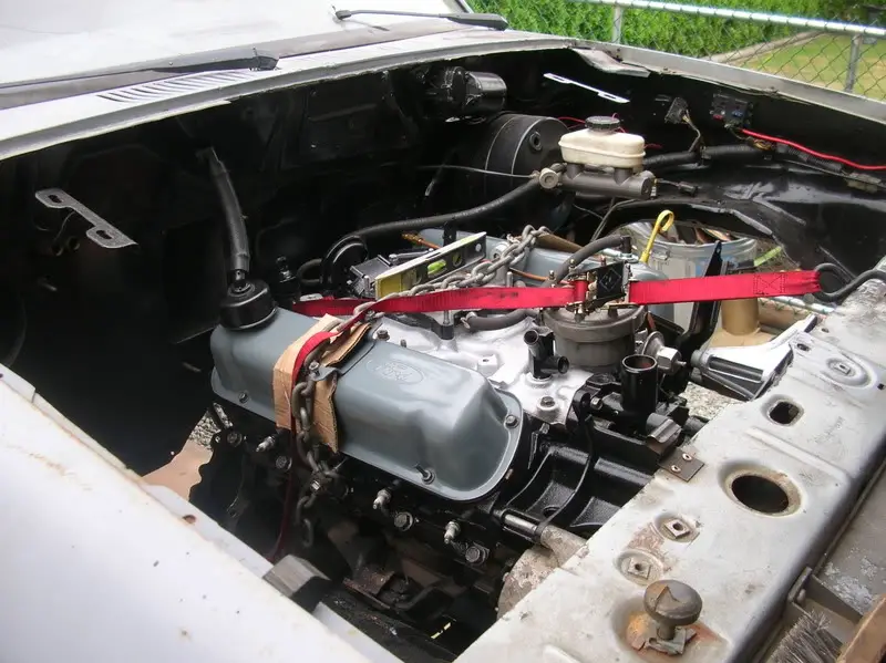

It started out as an 84 BII. I rebuilt it from tthe ground up with the 2.8 4spd 3" body and 31's. Then it went to a 5.0 h.o, c4, dana 35 and 8.8 with 35's. Now its a 351 H.O done up, c6 stage 2, np205, Sterling 10.25 rear and 79 hp king pin dana 60 in front, 14" of lift and will have 44's and 5.38 gears. Couple pics:
Dana 60 Sas front..(leafs for now will go coils after)
Rear view Dana 60 rear (now sterling 10.25) with 39.5 swampers. Still 2"wedge block thats not in yet.
rear view beside stock 4x4 ranger
351 going in(Building 460 and BB c6 now for when this thing blows:eek:_
