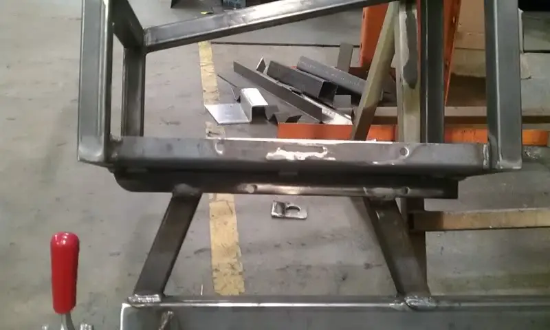

The sample bumper has tabs to hold the jerry can with a strap. I can cut those off, but don't know what a standard locking strap is or how it would work...
unless you mean you'd wrap the whole thing with a strap.

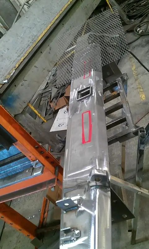

No room for 4" lights in the center, as the receiver bar runs lengthwise behind the face of the bumper. The right end has all the latch and stop stuff on it.
I can cut some sort of smaller light holes in a variety of locations, but it may be best to have a light in mind.
I'll mark up the bumper with some suggestions/options on some of this stuff tomorrow.
-James
Here's the strap I was thinking of. I think this will work well and keep the same cage look without the large tabs attached to the cage. (of course the photo doesn't show the cage but it shows where it would connect.) I can pick one up on Ebay. Also, I'm open to any ideas on the rear bumper..even large shackle tabs would work...just something to take up all of that space now. Thanks.

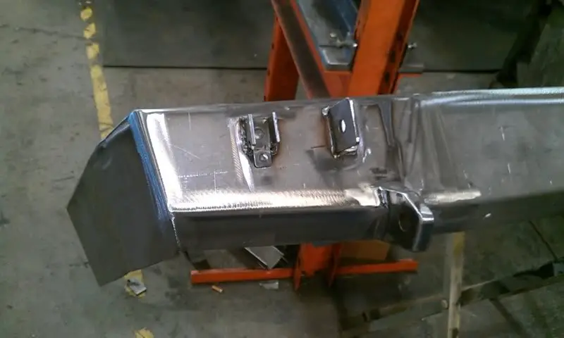

Only took this pic to show the clevis mount , latch and tab for lock on that side. Other side has only the clevis
Not sure if that pan on the jerry can hold down will fit in the cage? Or if the strap is even removable...or if the strap is removable inside the cage to allow for removal of the can.
I'd prefer to leave the tabs but will cut them off, no problem.

Jerry Mount: take tabs off and cut small place on the existing pan for straps to attach to. They're 1/16" thick so I don't think tolerance will be that tight. License plate tabs under mount.
The clevis on there now seemed to leave a big open space. If it were moved over to the left (more center) it would help take up that dead space. Rear bumper dead space: good size shackle mounts and call it a day?
Existing shackle mounts are welded front and rear very near the bumper mounts. The strongest location.
Holes or thin slots in the existing pan?

Thin slot will do.
slots and holes for plate.
tabs have been removed.

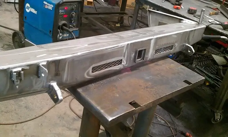

Idea for breaking up the surface is to cut two longish slots that sort of mimic the front design. I could further back them up (front too for that matter) by tacking in some of the pictured small expanded metal.
Thanks,
James
Thanks,
James
It's all you:hammer:... make it look awesome with your vision:smoke:. Thanks for working with me.
I like it. :D
-James

Idea for breaking up the surface is to cut two longish slots that sort of mimic the front design. I could further back them up (front too for that matter) by tacking in some of the pictured small expanded metal..
Front too? Sweet! Can't wait to see it and receive it!
