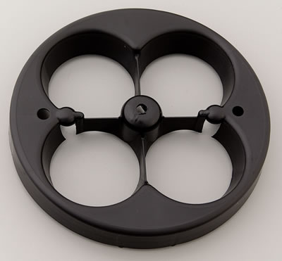

Added one of these "stubstacks".
Just adding the stubstack made the engine run too lean, so I upped the jets and that's when I got the new best times. In other words the stubstack worked, it let more air into the motor, which in turn needed more fuel to burn efficiently, there by making a bit more power.

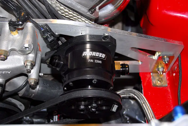

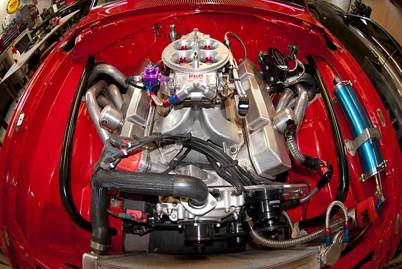

Added a new toy, a crank driven vacuum pump. The vacuum pump draws out blow by gasses from the crankcase and helps the rings seal better, which in turn makes more power. It's supposed to be good for about 30hp over the exhaust evacuation I was running before.
Started the motor today and seems to be a bit crisper and more responsive. Taking it out to the track this weekend to give it a try. Saturday night is the Nostalgia Drags:chug::burnout:
Wouldn't an electric vacuum pump be more efficient since it isn't connected to the engine? What's the Hg rating of this pump?
Electric's only pull about 5". This will pull up to 18", but since I'm running a wet sump system it needs to be regulated down to 12". Too much vacuum and the wrist pins can go dry:nono:

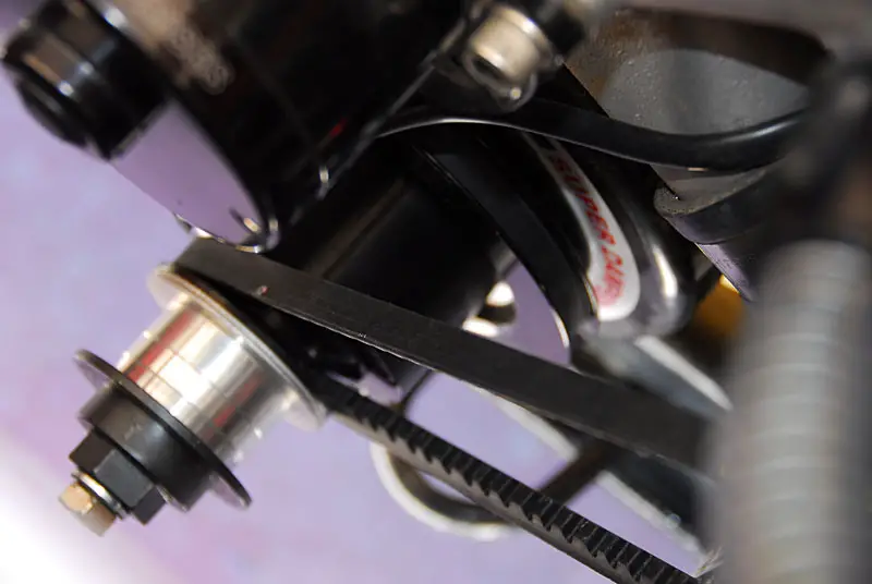

Even though this is engine driven, it's a net gain in power. As you can see the pump is geared to turn rather slowly. About 1/3 crank speed.
So I guess it's similar to an A/C compressor run in reverse? What's the brass flare fitting for on the side (air inlet)? If it's an inlet, wouldn't it need a breather element style filter? How do you regulate it to maintain 12 In Hg? Is there a way to use as an onboard air system to refill tires or fill air shocks?
Not sure what you mean since there is no brass in the system. It draws blow by out of the valve cover (not seen), runs through the regulator which is red and black, into the pump, then exhausts it out the other side and into a catch tank with a filter element on top to vent it. There is no air intake into the block.
The pump uses metal vanes.
Rick, I always install the front and rear seal backwards when I build a motor for someone using vacuum. The darn things will pull air (and dirt, etc) right through the seal otherwise. You might want to research that and see if you feel it's necessary. (I do) Especially with as much vacuum as you are pulling. Of course, if you already did that, then ignore this! :)
I'm aware of that. The IndyMaxx block uses seals made for vacuum pumps since it's a race block. Thanks for the warning though.

Fun with the new 10.5mm fisheye
That is an incredible picture & motor! :eek:
