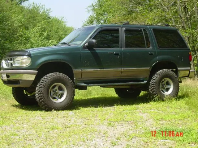

davidmmm69 - what did you do to your X?
First it is 2WD but it has torsion bars cranked to about 2 inches more to come.
spindals up front 2WD only can do this that is 3 inches.
each leaf spring pack in teh rear has 2 extra add a leafs and shackles installed in the rear also.
and 2 inch body lift to top it all off..
i was able to hack the front bumper a little bit to even it out and trying to find a way to level out the rear bumper, which looks hideous..
also removed the fog lights cause i destroyed them while beating the crap out of the front bumper.I was getting mad cause I couldn;t get any adjustment out of the bumper.waiting for some new bigger driving lights now.
and to top it all off. I took of my 31 inch BFG'S and added 33 BFG'S Mud tires.
and also added steps last year to it to improve how it looks from the side...
