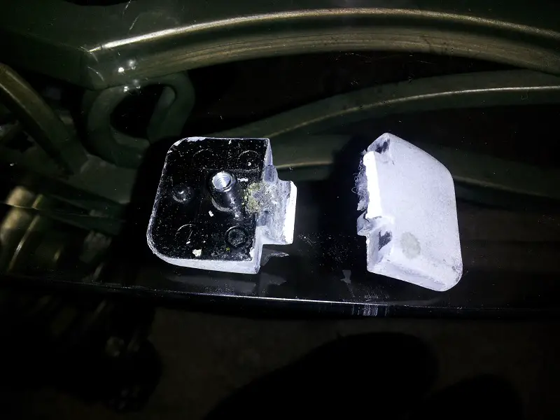

Finally got my interior panels off and my headliner off. but i broke my sun roof clips while taking off the sunroof.. minor set back. ill be driving without a sun roof for a few days.
Boo!
