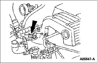

Has anyone suggested the coolant system temperature sensor? Not the one that sends a signal to the temerature gauge, but the one that sends the temp reading to the engine computer.
If your computer thinks the engine is too hot it could give you the problems you have. Idling high, weird shifting, loss of power, etc... are all noticed when the computer is trying to get the engine to cool itself off.

well the oddest thing I noticed when I popped in this SLL3 PCM, the engine idled at 500rpm.. given the truck was considerablly warmer but.. after switching out to the XDT2 it idled at 700-1000 again..
would this temperature item as you mentioned cause problems with the temp guage in the cluster? cos it seems to be working perfectly on my truck
