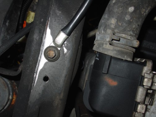

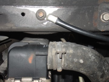

I would upgrade the alternator wiring: a a “Big 3” ( alternator B + terminal to positive battery terminal, negative battery terminal to frame, frame to motor ) wiring upgrade. Take a look at http://www.explorerforum.com/forums/showthread.php?t=152430&highlight=alternator+wiring.
This will make sure that the truck is well grounded and bonded together.
After this you should be able to ground where you have it. Or, if it were mine, I would ground directly to the frame.
Good luck ....

Found new grounds in the fender bolts.. and it barely reached those.. I noticed no flickering. I'll have to test more during the night.

Daniel, how come you didn't ground it like Aldive said? It's better to do it that way now than regret it later... Did you ground it with the type of wire he suggested?
i don't go all the way to frame and drill a hole... thats probaily the best ground, but you don't need that for alot of things. I'm pretty sure ford uses paint free grounds on the core support, fenders, and firewall considering ive seen plenty of them
Understood, but I'm asking because Aldive practically walked him through getting this right. It seems it would be best to follow this plan through and not get in trouble down the road - literally.
I don't have a drill, or buncha wires laying around.. the ground wires from each light are not very long at all.. and barely reached the fender bolts.. which are unpainted and work perfect for a ground.

Understood, but you should mention that right away, otherwise it looks like you're ignoring the advice given. You don't want to short out at -50, just wanna make sure you're doing it correctly.
It's nice n warm at 45 above right now.. snow is melting.. roads are clear... time for summer.. hopefully it stays this way..
I did mention it.
"The wires aren't too long, I grounded to a screw that's on each side.. which goes into the front metal part of the body."

Did you fix the problem with the flickering?
Yep, I did.. and it solved my oil gauge problem.. I found better grounds and everything was perfect. [Except the CB Reception...]
