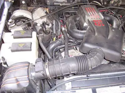

Intake is in!
Wow, what a PITA. It is truely a great intake, but the instructions are pure crap, and they are actually WRONG. The fit is tight, and even though it says it is specifically for the 1998 Explorer Sport, there is no way in hell anyone ever tried to fit one for R&D purposes. The factory intake has 3 ports, 1 for the IAC, one for the PCV breather and one for the IAT. The Volant intake has 2.
I chose to swap the MAF harness and use the IAT in the MAF (since I swapped to a plastic MAF last year).
