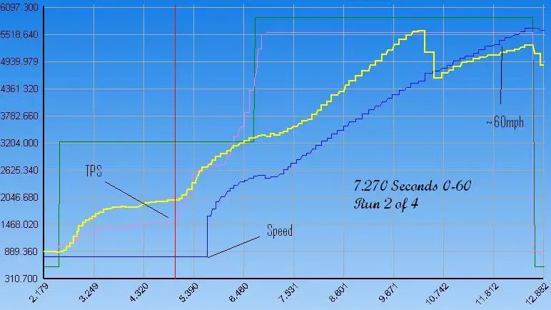

Let's see the 0-60 DATA with a screen shot. I'll do the same with every MOD i've done, plus the weight reduction I've done. If your 0-60 is the same as mine, you've found some sort of secret.
I find a long, flat, straight, secluded spot.
I start from a complete stop.
I mash the pedal to the floor and hang on.
The times are between the PCM and my PC; I have nothing to do with them.
There are no secrets, the equipment, steps and procedures have been meticulously laid out in this thread.
Your altitude is 361 ft, mine is 10 ft at best (on the coast), but that isn't too much of a difference. I also have fresh plugs, wires, O2's and 93K on the clock. Curb weighs (factory) are identical for the 1998/2001, so you should be lighter.
Send me your 0-60 datalog and I'll convert it for you... That way we can be sure its the same procedure. Then you can compare side-by-side. fred (at) (click on my user name for the homepage, that's my domain)
Okay - I'll do that. I'll send you 3 runs, hopefully this weekend.
Can you post em here so we can see to?
Sure... if Jakee's up for it.
That's fine. (posting in here) This thread is much better than mine.
It's raining so I won't be able to run today.
Just sent 4 datalogs.
TP is the red line, since you are starting at 2,000 RPM's, I had to look where you mashed the throttle at start, when it spikes, I marked it.
Run 2 (pictured) was 7.270 seconds, run 3 was 7.11.
You've still got me by a three tenths of a second, nothing to worry about there Jakee.
You're safe for at least a month :D
