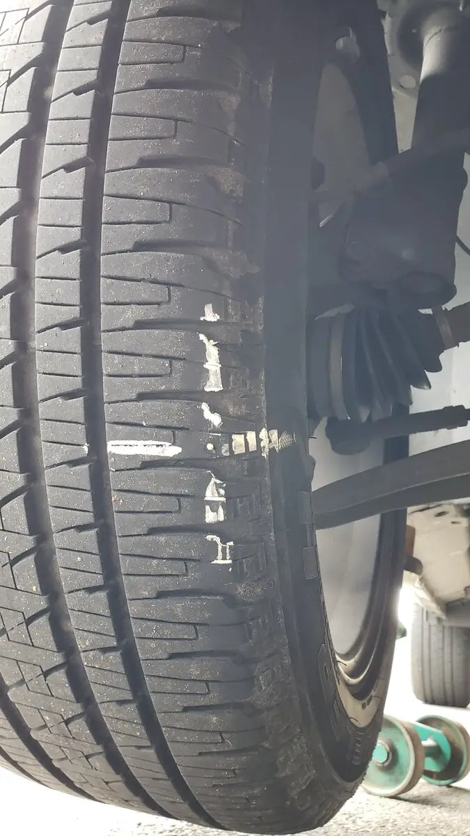

Engineering answer: Constant over or under pressure will cause tire failure. A tire is a multilayer balloon. If it is run a over-pressue the tire will wear in the center. Under-pressure the tire will wear faster on the shoulders. Sufficient under/over pressure will cause tire failure. Under-pressure will the tire to concave and overheat causing delamination of the belts. (I have seen this on multiple brands of tires. The usual warning is the tire develops a bubble, vehicle may or may not develop abnormal vibrations. I have both seen this and felt this on both the tread and the sidewall of the tire.

As to the patch/plug the safest answer is always to replace.

If the OP's tires were under warranty what would happen with almost all cases? How many owners are tracking that a driven axle should not have 2 different size tires? That an axle with any form of trac lock differential is in the same boat as the OP? Must replace both at the same time. Yes, selectable as well.
