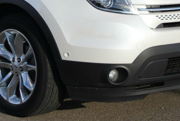

Hi all,
I'm soon to be a new owner of a 2012 Ford Explorer Limited. Can't wait.
I do have two quick questions, I've also attached a picture to help with them.
#1 - What is/are the sensor(s) in the fender (near the wheel) for?
#2 - There's some type of vent on the left side of the front bumper. What's it for?
I can't say I've seen either on other Explorers I looked at.
Thanks!
The vent under the bumper is for a cooling duct. You have a limited with towing and that duct moves cool air to the back of the engine and transmission on vehicles equipped with the Tow pkg. And I think the sensors are for the Cross Traffic Alert system. I do not have a limited so I do not have that option on my Ex.

Welcome to the Forum molakai. :wavey:
That sensor is part of the Active Park Assist system which is available only on the Limited.

The sensor looks like its for Park Assist.

I haven't received the vehicle yet so I'm not sure what option(s) I have, but that's exciting to hear it's the tow package & active park assist. I remember trying to test drive a Limited with APA but there was something missing on the vehicle and we weren't able to try it at the time.
So would it be safe to assume I have 302A if I have APA with a 2012 Limited?
Bryceb, that's a heck of a time-saver. Wish I knew about that before, cheers.
Turns out I do have the 302A package.
Thank you everyone for your help, greatly appreciated!
That little air duct is there to cool the "back" side of the engine area between the block and the firewall. The engine is transverse mounted on these. The little duct has to come off to change the oil. There are 3 thumbscrews that need a twist to release the duct.
