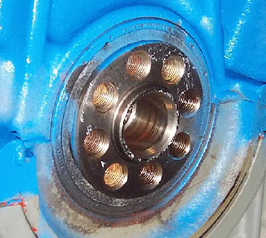

ok ran into a little problem today.. i was removing the flywheel bolts and managed to break off the heads on 4 of the bolts.. i was thinking of buying a bolt extractor from the auto parts store but was told that that wouldnt work .. a guy gave me a number of his friend which said my only option was to weld a nut to the top of it and then extract it that way.. he priced that at $80 dollars.. which is out of my budget since i still have parts to buy .. does anyone else have any other way of trying to remove those bolts? i also rented a harmonic balancer puller and to my surprise didnt work .. is there anyway of removing it without a puller or what should i do?

Were you able to separate the flexplate from the crankshaft?
There is a spacer between the flexplate and the crankshaft.
The thickness of the flexplate and the spacer requires the bolts to be fairly long. Once the flexplate is removed the bolts will no longer be in tension. If there is enough left to grasp with an adjustable locking plier then soak the bolt shafts with P B Blaster or equivalent for a few hours to make extraction easier.

i was able to remove the balancer with a 2/3 jaw 5 ton puller but the flex plate is where iam having problems .. i was able to removing 4 of those star bolts but the other 4 are still in place .. most of the heads on them are still be gripped with locking pliers.. i will see tomorrow if i purchase some pb blaster and try that method. i will try and find my wifes camera so i can take some pictures of my progress .. i sure hope that i can remove those bolts without having to pay someone $80.00 . fingers crossed
those are inverted torq bit sockets you should be able to get those at your store no?
