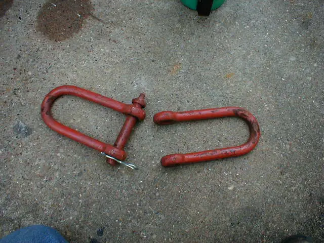

what are my options for a front tow point
like tow hooks or d ring mount for my 94 X?
anyone have any pics of what you've done ?

This is what I use, but I don't have to worry about a front spoiler or air dam. I have one on each side, and they fit snugly enough that they don't rattle. They went right through the existing triangle holes in the frame.

Here is what they look like. I got them for $15 a piece at an Ace hardware. They were called "The Big Orange". I have never seen them anywhere else. I told a friend of mine that I needed a shackle that would fit across 3 1/4" and he showed up with this 145 pound shackle from a tug boat or something... he asked me "Don't you think this is going to lower your ground clearance?"...:hammer:
