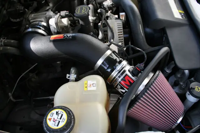

I used a KKM and a K&N (02-03) and made one for an 04+
yeah i looked at KKM and just the adaptor and filter is $135..kinda pricey

afaik KKM is the only one made for 04+, and yes it's pricey for what it is. I really didn't like keeping the rest of my stock intake with it either.

bigapple: you have an 02... the 04's and up are designed different. The MAFS housing and the stock airbox is all one part and doesn't unscrew like yours... I wish it did! If I owned an 02-03 the FIRST thing I would buy for it would be the K&N FIPK kit.

I got mine from KKM on Ebay - was 135 shipped, which will save you a few bucks over what you'd get straight off his website.
blitzk that looks drop down sexy! lol
