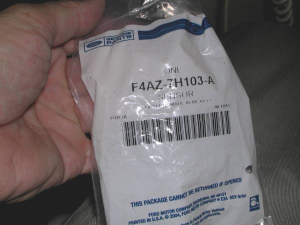

look at the "My 4R70W Rebuild Diary"... as we speak the last pix are of it. An 8mm smallish bolt removed and it pops right out..... go look....... easy replacement. (There is a pic of the parking pawl that shows the OSS inside the case too. Ford Part #F4AZ-7H103-A. It is NOT in the tailshaft housing but near the rear of the case on the driver's side... I have a "used" one for sale <joking>.

Well here's some pics in case they help.... Here is my new one, still in the package.... cost me $16, not including tax...
