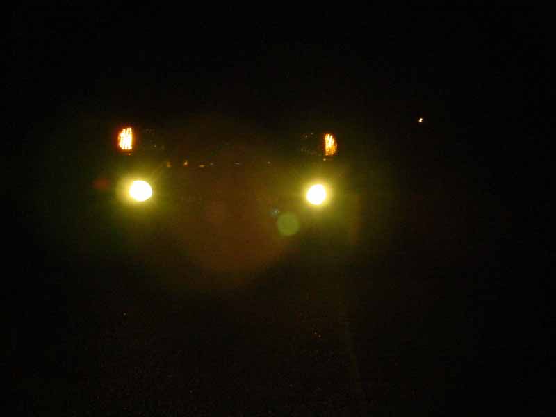

just rip the stocker's out..i put some "blazer" aftermarket real yellow fog's in mine..they are awsome $16 down at wal-mart also so easy and cheap to replace and they give off a good amount of light..alot more then stocker's!!!!
2004-01-12_003.jpg_idshr_idshr
don't mined the other set of driving light's.. :D
here's one with just the fog light's
