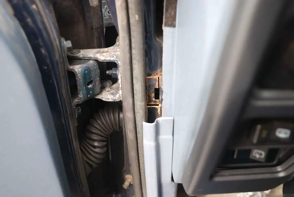

They had a wire cut coming out the back of the headlight I found it yesterday. Thanks. Gonna mess with the dome light today. Where exactly is the door jamb switch?? That's what I always said they didn't want ppl to know they were getting out of the truck at night
It's in between the door and the body. When the door closes it depresses the switch.
The switch can be near the bottom center of the photo.
In your picture. The rubber thing that holds the wires. On mine that rubber thing comes from the body of the truck then when it connects to the door. There is some kind of box type thing I can't find that switch on my truck. Or even a hole where it would have been. Could it be inside the box thing I'm talking about. I would put a picture on but I can't figure out how to put the pic up
