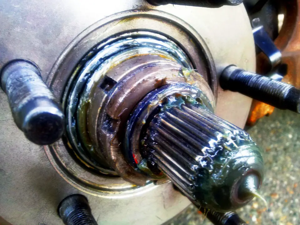

There should be two nuts with a washer that has holes around it between the two nuts. Those two nuts should be locked into each other. That's what keeps it from coming loose. Then there is a snap ring that clips onto the spindle that keeps both nuts from backing out completely and falling off.
