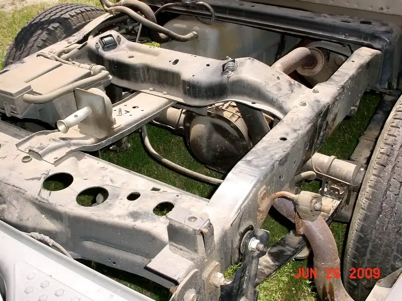

So you'll have an idea of what you're up against here's a photo with the bed removed.
That Photo Does Help That Is Ford For You Make As Hard As It Can Be Looks Like No Front Acess On Them Back Only
