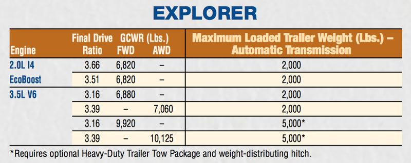

So there are a few answers flying around and they seem to be addressing different things.
-The Explorer with tow package has both a 4 and 7 pin plug so an adapter is unnecessary.
-The Explorer has a Gross Combination Weight Rating (GCWR) which differs from the Gross Vehicle Weight Rating (GVWR). The GCWR includes a trailer while the GVWR does not. The GCWR ranges from 6820-10125 pounds depending upon your Explorer's setup in respect to engine, driven wheels and tow package. I have attached a pic from the Ford website.
-The U-Haul tow dolly weighs 750 pounds when empty and has a "Max Load: 3,450 lbs. when towing a front-wheel drive vehicle, 3,900 lbs. when towing a rear-wheel drive vehicle."
-The U-Haul Auto Transport Trailer weighs 2210 pounds and can carry 5290 pounds.
-One thing to keep in mind is that when empty, both the dolly and transport will be incredibly loud when unloaded and driving over any road imperfections. Think of an aluminum ladder falling down.
