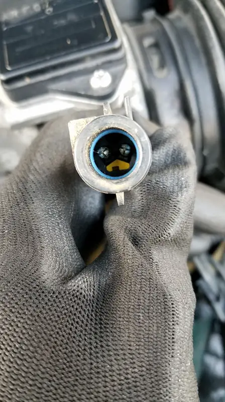

Attached is a picture of the connector I'm talking about. I may be wrong in calling it an engine coolant temp sensor connector.
I think I know what you're talking about, there's 1 or 2 round connectors for the negative cable. They're not for the coolant temp sensor though. Honestly, just splice it however you can but please don't simply crimp. Solder and double-wall heatshrink with glue inside is the best way to go. Corrosion is very prevalent in these cables near the battery due to the acid. With crimped connectors, you're asking for trouble down the road.

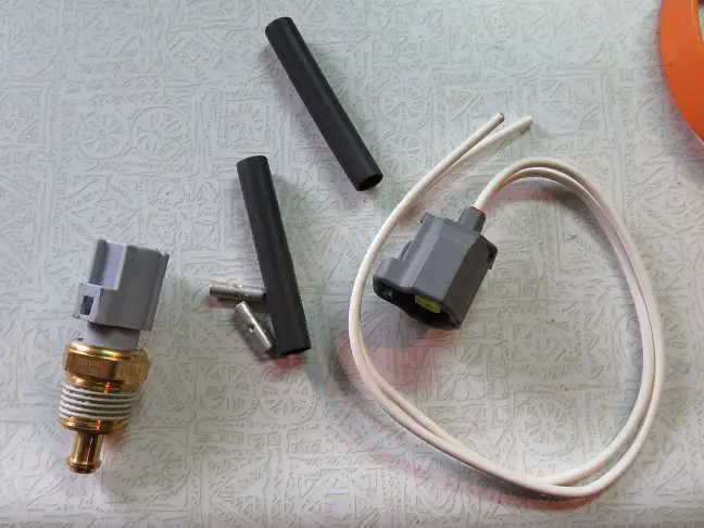

Here's a pc of the Delphi ECT kit. Notice the extra pigtail connector. It even comes with crimpers and heat shrink tubing.
Here's a close up of the two connectors.

I'll need to go back and take a picture of the whole cable (it's been raining since my post). Like natenkiki mentioned, it's two rounded connectors. That's why I thought I would try the NAPA cable pictured below (1st pic) because that's the same rounded male connector. That connector connects to a rounded female connector which is bundled into some convoluted tubing/electrical tape and routes under the engine bay fuse box. The male connector pigtails are currently wrapped in some electrical tape and bundled with the main cable in convoluted tubing. Those temporary type terminals were added at some point.
The cable I ordered from NAPA ended up being the cable in the 2nd picture below. Which is the same cable I had previously ordered on Amazon.
that double connector is the computer ground definitely solder and heat shrink or you will have grounding problems.

FYI...on my 94, the factory connector did not match the new ECT sensor...so I'm having to use the pigtail Delphi provided. The OEM wires are slightly smaller (12 guage vs. 10 guage it appears). NOW what I hear is that the sensor doesn't care about polarity..i.e. the two wires on the pigtail are both white, yet the OEM wiring is Gray/Red Stripe and Lt Green/Red Stripe (carries 5v).
i'll know for sure if that's true, once I solder it all up.
It's just a dumb resistor and works the same no matter the polarity. Any way you please!
