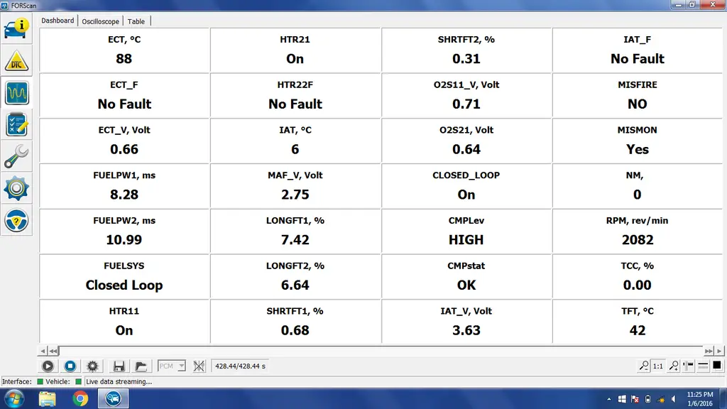

Now onto the screen shots. I did see some negative values for the ECU trying to lean out the mixture but not much and not a very high percentage. Anyway here's one at idle and one under a load.
Idle:
Under Load:

Also, when looking at the fuel trims, be sure to look at both the short and long term. Only those two together tell you whether it is commanding overall rich or lean.

Honestly I think it's fairly zeroed out as far as fuel trims. Maybe a hair on the rich side. But I don't get any horribly high or low numbers (apart form 18% at WOT). The o2 sensor readings are literally all over the place. .1 .2 .35 .45 .67 .76 .88 etc they just bounce all over. Is there any way to record a video in forscan so I can upload it? Or are there any other parameters I can add to my table that might help us figure this out?

Also O2 sensors only sense oxygen, not fuel. High voltage means rich(lack of O2), low voltage means lean(lots of O2 in exhaust). (a mixture is rich or lean on fuel) The normal operating range of a Ford narrowband O2 sensor is 0-.9 (they should vary at least from .3 to .8)
The .88 was a rich reading but you can not say the vehicle runs rich by looking at the split second in time that you captured that O2 reading. That is why we have Fuel trims. STFT and LTFT should be 0 plus or minus 5. So -5 to 5 would be fine. Between 5-10 you have a small issue. 10-15 it is a noticeable issue, 15-20 is a large issue. I have seen codes set on 1996 on up vehicles from 10 and up, but if you don't have a code it doesn't mean you don't have a problem.
If the problem might be A/F mixture related, you need to look at STFT and LTFT at Idle, and 2,000 rpm's in park.
Could you post screens shots of those please?
