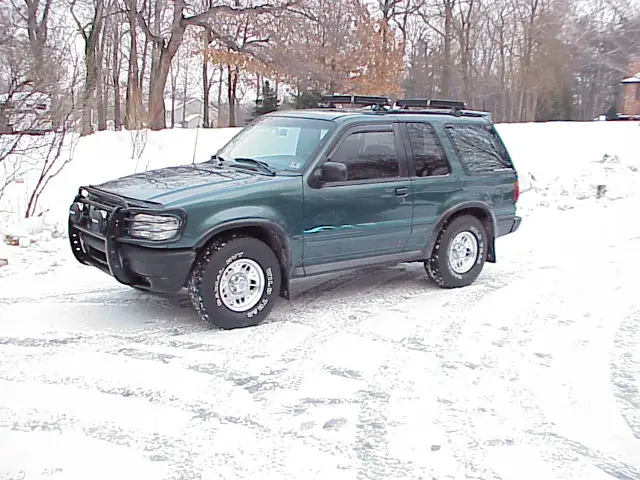

IMO A grill guard is more likely to damage the body (fenders, hood, headlights) during minor collisions. This happened to me. I slid through a stop sign during a snow store and T-boned a car @ 6mph . Because of how the grill guard attached it was able to flex back during the impact which busted my passenger headlight and put a dent into the hood. If I didn't have a grill guard the bumper would have absorbed the impact and not damaged my body & light.
