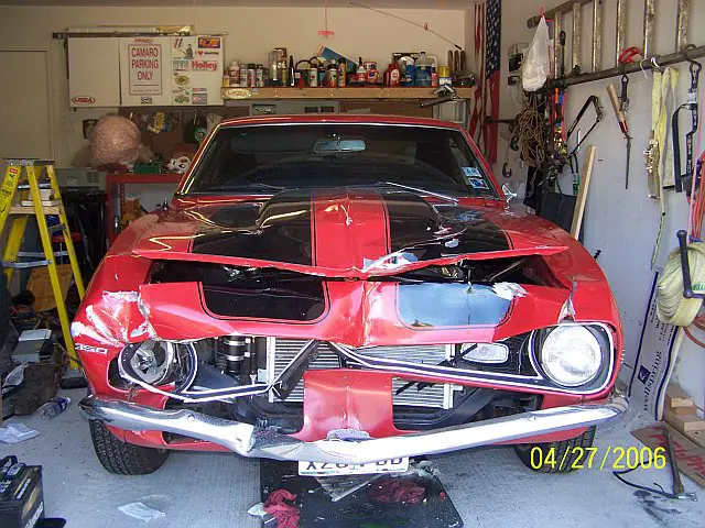

Let me try to be a little more clear. I have a car that was wrecked. Front clip is shot. I will be replacing the whole front clip as money permits.
My real question is when to paint the front clip? Do you paint each fender and then assemble or do you put the whole thing togather and then paint it?
I'm most likely changing color on the whole car as well. Not sure if that changes the decsion process?

it changes the decision process for sure.
repairing a fender, grill, bumper etc you can often get away with spraying the parts then fitting them. I would prefer to fit them, then remove them, then have them sprayed, then install.
If you are changing the color of the whole car I say get it all put together, then have it sprayed, also plan to remove all glass, trim, interior and drivetrain :)

with out question paint it on the car detrimed

BTW that first photo made me cry
I don't know how Monmix feels about this, but if you do change the color I wouldn't take out the glass unless you want it to be a show car. Put it all together then put on the color.
If you plan on having it painted it will cost you as much to have it jammed as the complete outside of the car.
I would remove glass and every thing.
