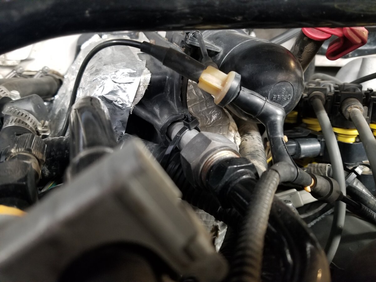

Posted below: Photos of engine bay and possible reasons for vacuum leak
The Mass Airflow Sensor, if it has any visible dirt, is too dirty. Its a easy thing to clean, just spray it with carb or fuel injector cleaner, let it dry and reinstall. Don't touch the filaments with anything or you can damage them. If you changed the plugs, then maybe its due to plug wires.
First, I would spray that engine compartment down with Simple Green or other degreaser and hose it off, its filthy. I off-road my Explorer more than I drive it on the pavement and the engine doesn't look like that.
That second picture is a pre heater that uses the exhaust manifold to heat air to help the engine get to operating temp faster in very cold weather. It slips onto the fitting on the bottom of your air cleaner box. If its not checked during smog inspections, then I would remove it as its not needed.

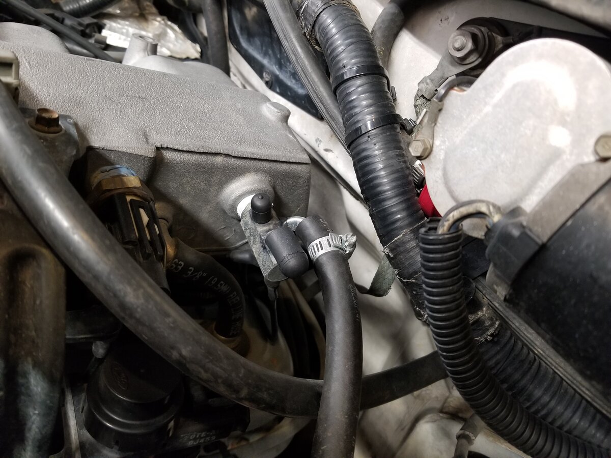

I have been working on my Explorer since 1995, so I hope I know its systems. It looks to me like you are missing some vacuum lines. They might just be plugged at the tree, but there should at least be one running to the vacuum reservoir.

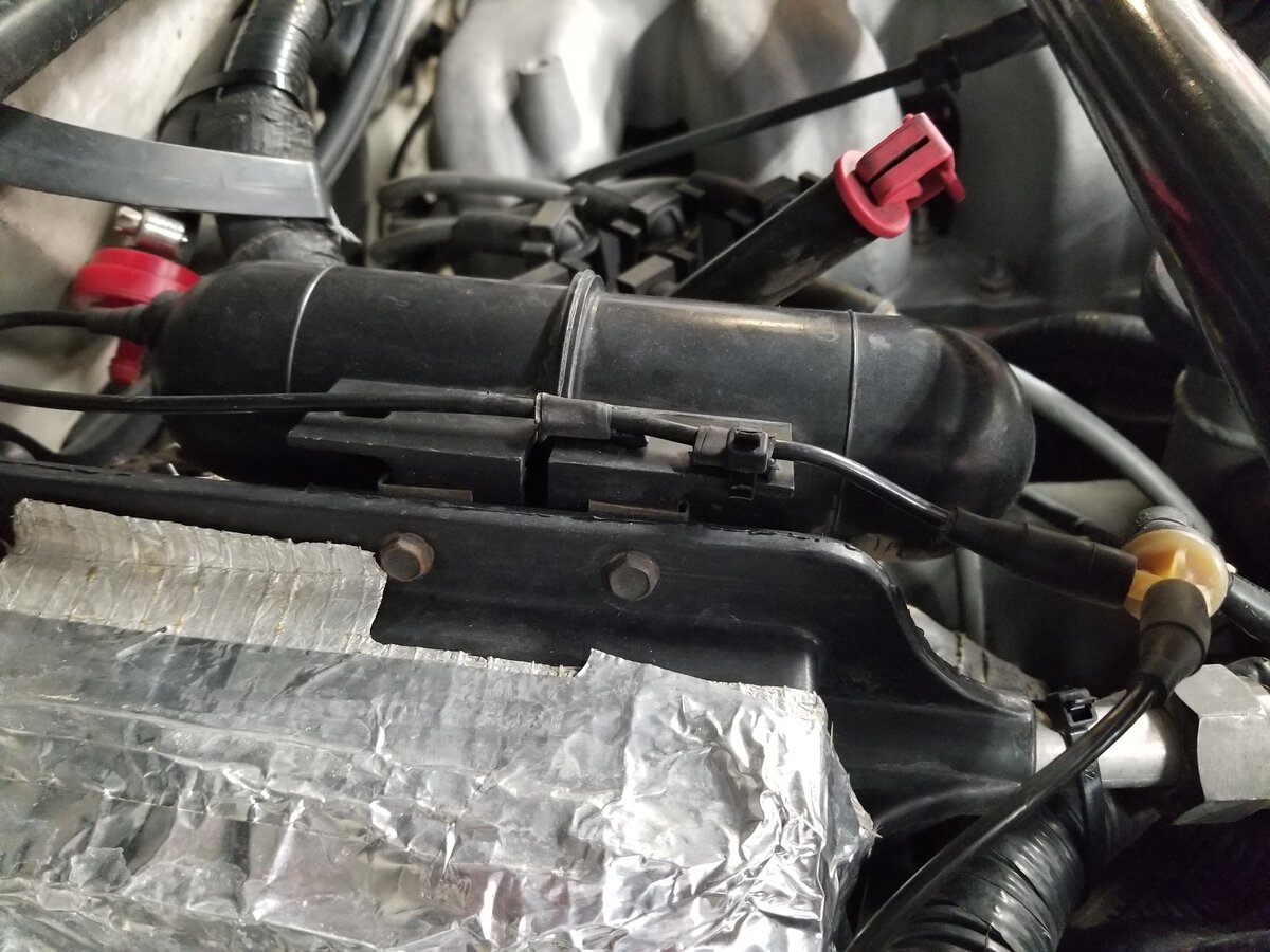

Here is what they look like on my Explorer. I have a shock hoop support running across the top of the engine, but you can see the vacuum lines. The line with the elbow and white T on it runs to the HVAC controls, with the other line running to the reservoir. The line pointed at the camera is the one you had in your hand in the pictures you posted.
Picture of vacuum tree on driver side towards firewall. All the vacuum lines come off of this.

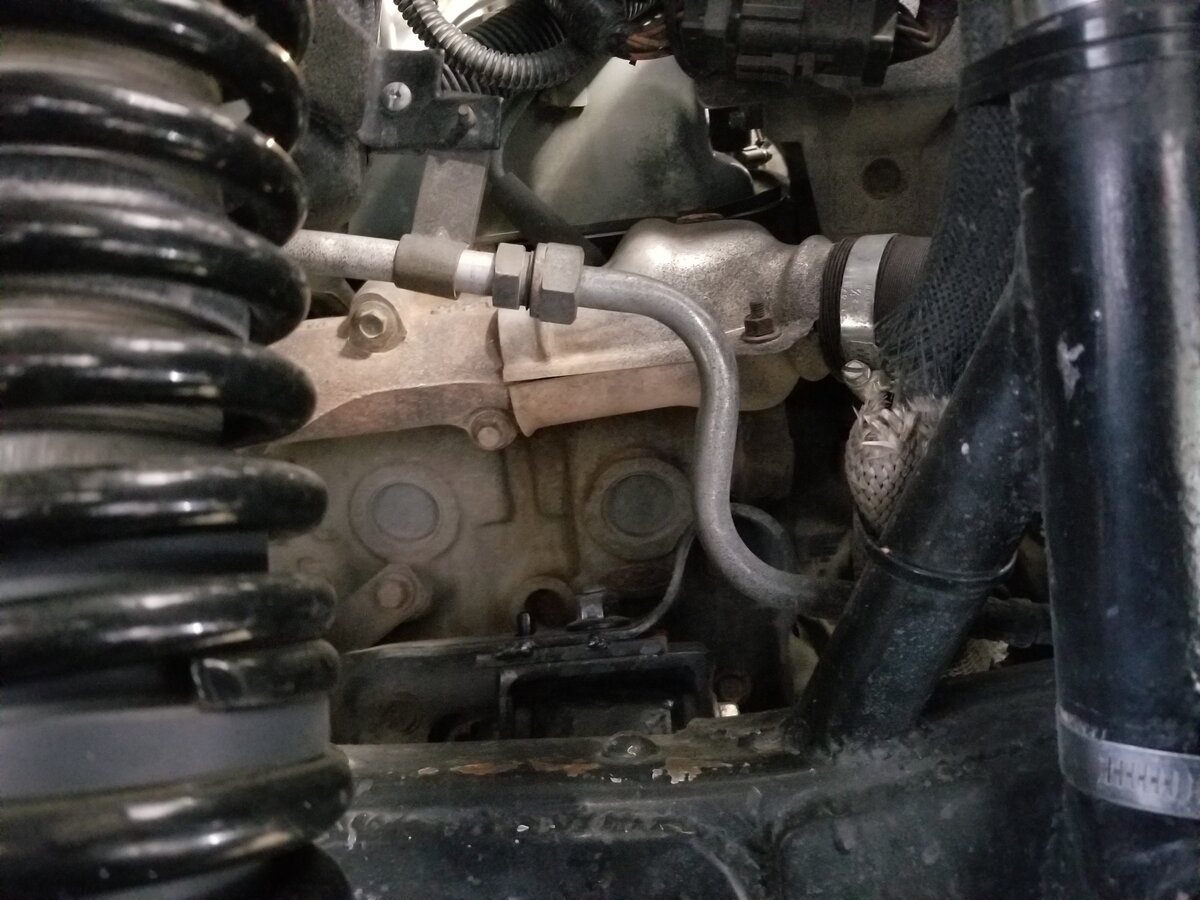

Pre-heater on passenger side exhaust manifold. That disconnected hose should run from this to the air box
Interesting, thanks for your insight! I've heard the manual transmission Ex's have fewer vacuum lines... is that relevant here (I have a manual) atleast for the plugged hoses? Also, anything i could do immediately that would rate at a higher "importance" than others? Thanks
The auto trans uses one vacuum line from that tree, which would be plugged on yours. I would just start by plugging vacuum lines and see if the rough idle goes away. Clean the MAF, its probably time to change the plug wires. Its usually one of those things, or a combo of all of them that causes your issues.

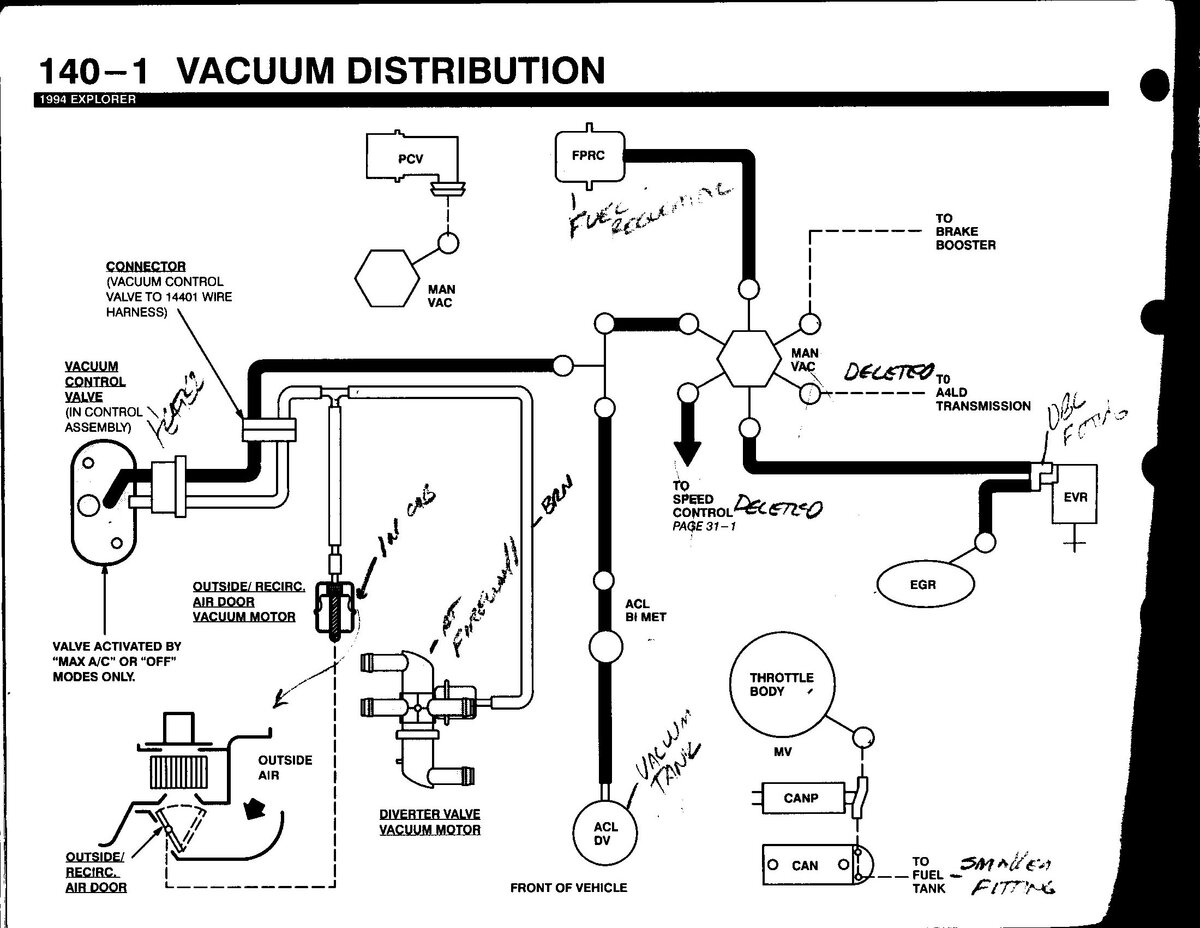

Diagram of the 1994 vacuum lines, not sure if the 1991 is different.
