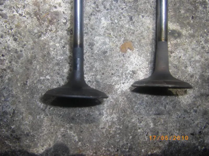

Rear chain snapped on me as I was shutting the engine off so at minimal rpm and;
exhaust valve not seating
The bent valve on the left next to a straight valve
the dent it left on top of the piston.

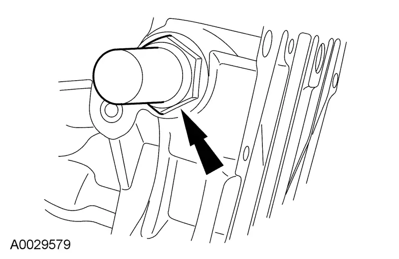

Above is a pic of the revised front tensioner. The new rear tensioner will be identical in looks to the one you remove.
Torque is 44 Nm
Make sure you screw the new tensioners in by hand as far as possible as the thread in the head can get crossed really easily.
In the pic you can see a circle to the left of the tensioner. This is the gallery plug that needs removing to insert the restrictor pencil.
Torque is 44 Nm
