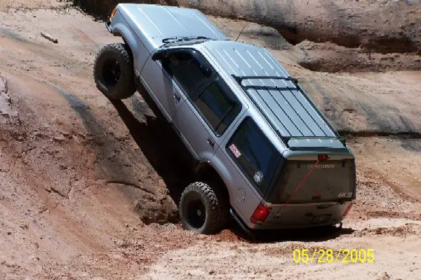

I drove that truck everywhere... I lived in Louisville, KY. The truck has been driven to Moab, Wisconsin, Pennsylvania. Florida, Tennessee, and all over between -- and wheeled everywhere.
Here are a few more pics of my truck in action.
