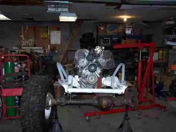

My new build has ZERO lift, but is running 38s. Of course, everything that gets in the way of the tires will be removed. :thumbsup:
Here's a teaser shot:
Awesome! Thats a insane project you got going there. What kinda monster is that gonna be? Glad I found your posts as I was planning on spending big $$ for a lift sometime just so I could off road better. Looks aren't that important to me. $$ and capability are.
It is an 86 Ranger -- sort of. I just added specs on my vehicle specs tab.
It will have an extended cab body and full exo cage once it is finishedl. Only front sheet metal will be fender tops and hood/grill all else is tube.
