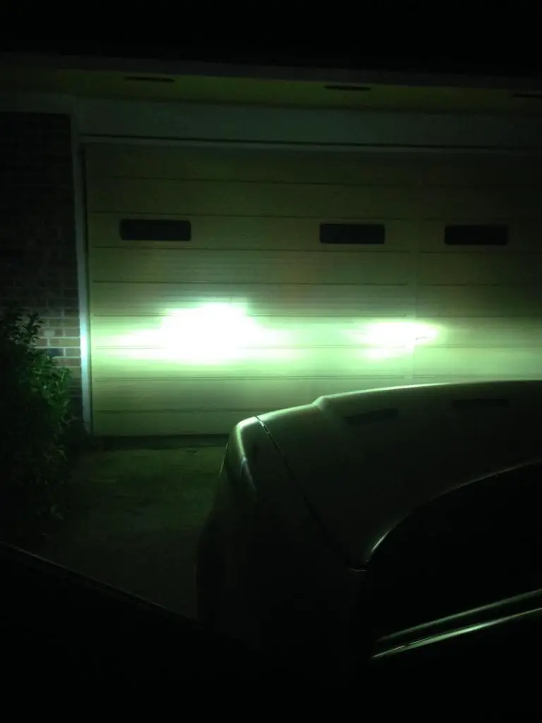

I have a cheap set of HID's in my truck 6k also and they are not illegal at all and mine do just fine in the factory housing take a look for yourself
The cheap HID kit you have on your vehicle is also illegal, and unsafe.
That blob of light on the garage door SHOWS how poor the light distribution is. The hot spot is way too concentrated, and is way too high, even for an SUV. That bright spot going up and to the left is probably going right into the eyes of the drivers of oncoming cars.

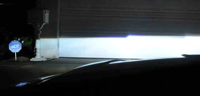

THIS is what a real HID light distribution pattern looks like on a garage door:
Notice the sharp, sharp horizontal cutoff, and how even the high, high intensity is on the whole beam below the cutoff.
